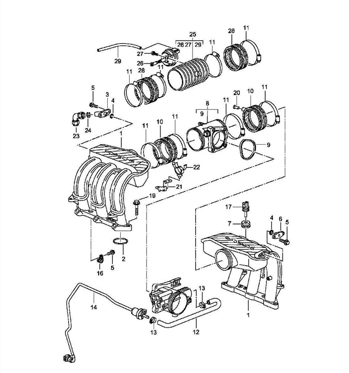

Regarding the othe inlet tube (towards the seats) there is some sort of vacum controlled flap there, Can I just pull the vacum line out from the flap or do  I need to disconnect it from the sensor (electrical) contact cloose to the airfilter?
It seems to be fastened hard and I dont want to breake anything.
You should be able to disconnect it from the electrical unit without a problem.

So the line (position 29 in the spare part manual) shall not be removed from the actuator (26)?
Shall it be removed from the sensor (were the electrical contact is on top)?
I'vetried to pull without any luck.

The connectors take a heat soak seat at the fittings and sometimes require a little heat to loosen them up.
As I mentioned earlier, we often use a heat gun to loosen up these connections.  If you cannot get yours off, remove it with the switch still connected.
