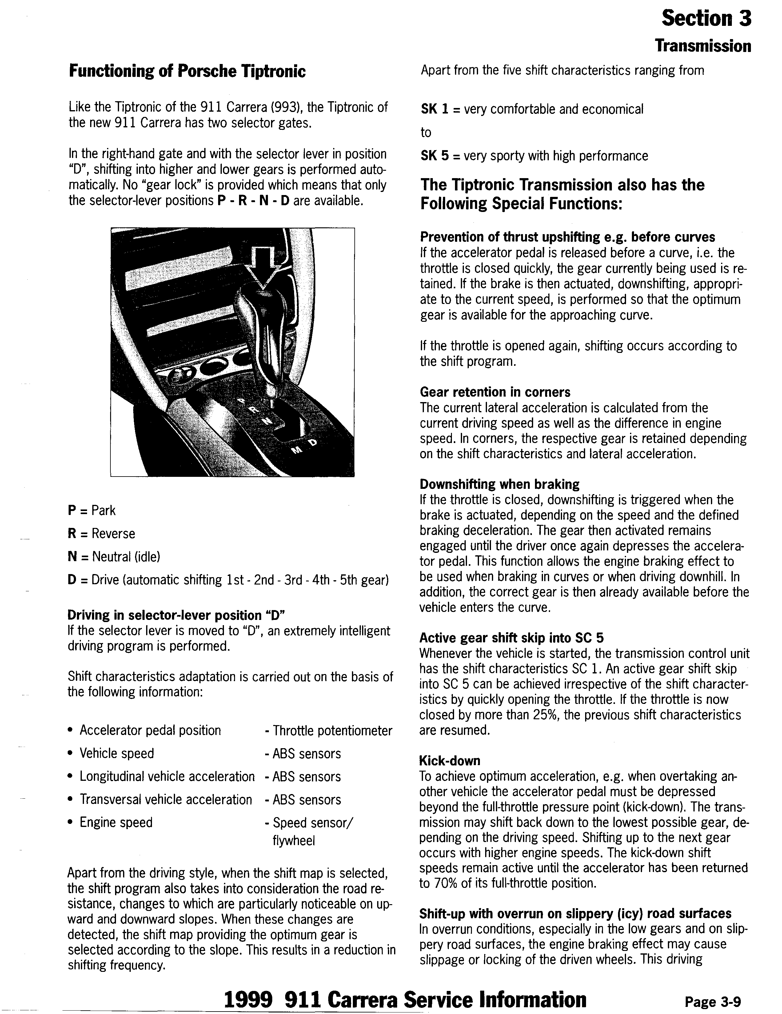

Sorry, only 6 modes...
On paper the Tipronict sounds great as it will adjust its shift points to your driving style. The problem is that it to be re taught every time the ignition is switched on. Otherwise, it defaults to gas economy mode and shifts up at a way too low engine RPM. That’s why I always use the steering wheel buttons instead of “manual”.

Yes, you CAN train it to start in first from stop.  A good indicator is when your mpg is below 16.5mpg.
Get the upgraded Siemens brain, which holds over from drive-to-drive.
Somewhere on the internet is a diagram of seven different driving style training imports the Tip uses to train itself (I thought I had saved it, alas).
