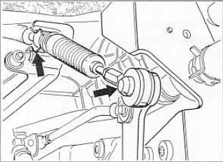

3. Detach selector lever cable from deflection lever and transmission support.

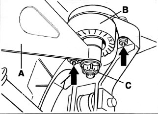

5. Remove the left transmission support with hydraulic mount.
Note:
The fastening nut M12 © must not be loosened. The transmission support will otherwise be damaged.
A -Transmission support
B -Hydraulic mount
C -fastening nut M12
