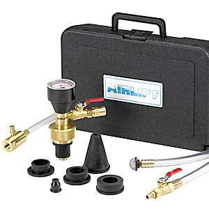

The biggest problem people run into with doing DIY service is not knowing what they are getting into before they start, and then trying to figure out how to get out of the predicament that they now find themselves in.  Like all vehicles, these have their idiocracies, and there are a lot of tools that can make the project a simple afternoon of saving money and personal satisfaction.  Vacuum filling systems, like the Uview system Porsche uses to refill these cars can be used on anything that is liquid cooled:
It doesn't seem awfully expensive.
And the BMW V8s in the house would probably benefit as well.

There's a howto with that device, written for the Boxster, IIRC... I think it's in the original post somewhere.
