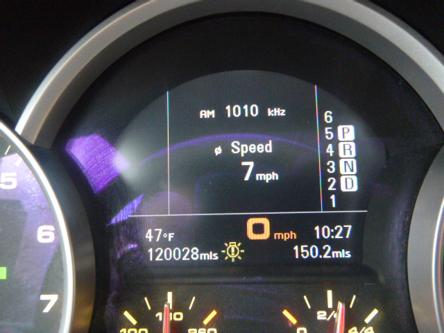

post-77842-0-81559800-1442976718_thumb.jhmm...that's curious. my issue is I get an odd display/warning in the gear selector indicators but the tranny upshifts and downshifts smoothly through all gears and it isn't throwing any codes! the car drives normally but the cluster gives this wacky warning after about 25-30 mins of driving. I've driven 60 miles like this and no problems encountered whatsoever. I had the tranny serviced at 119k before this started happening.
The display with the all the PRND lit up can mean your transmission is in a Limp mode. (Degraded mode).
You need to get the codes read to determine what is causing the fault.

hey big! thanks for the reply. that's the crazy thing though, it's not showing any codes particular to the instrument cluster or ECU when we scanned it! it actually happened once when I was at my independent getting some vacuum lines swapped out and he immediately connected his  scan tool and there was nothing showing other than the vacuum and intake leaks I was there for in the first place. there's no reduction in performance and I can see and feel the box upshifting and downshifting normally as I drive it. it doesn't lock up in any particular gear. I can turn it off, turn it back on and it's back to normal for another 30mins or so. I'm guessing it's electrical - something is getting hot and causing a bad connection.
Yeah check your connections.  I caused that one time when I was taking the control module in the dash apart to replace the handle and some other stuff.
