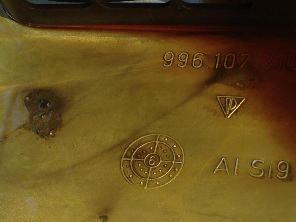

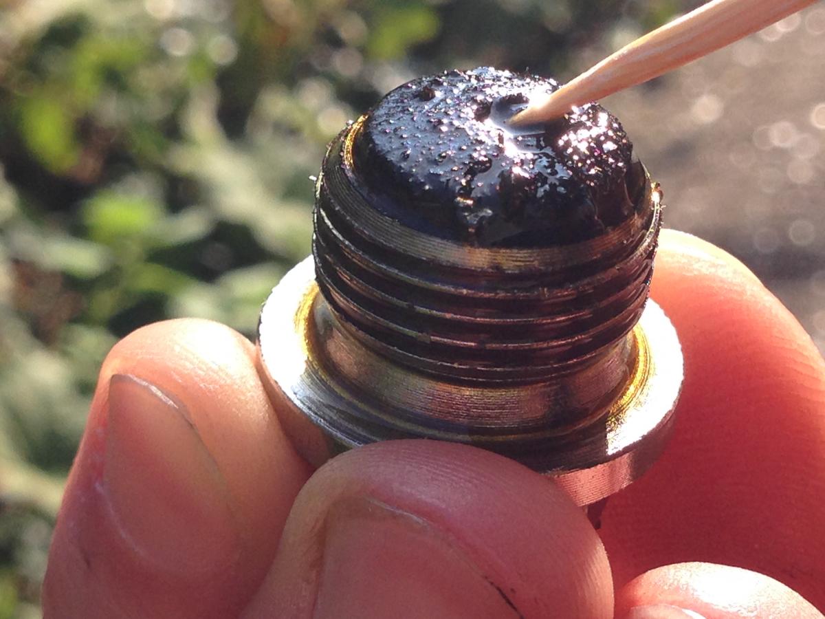

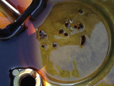

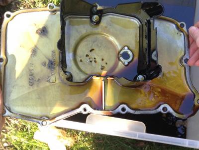

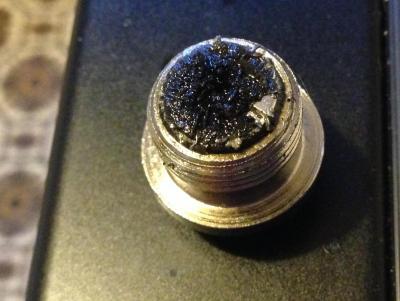

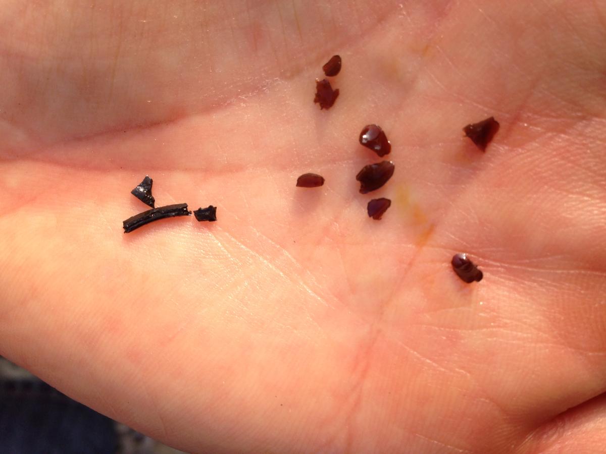

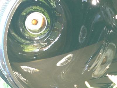

Hi John & Ahsai, I dropped the pan today and took lots of photos of it, the mag drain plug and the inside of the filter housing (mags on the outside). Not sure what this means for the engine..?
The parts from the centre of the pan were what looked like part of a rubber seal (black bits) and dark brown plastic. The metal, centre and sides was mainly ferrous. Some of the photos are pretty close up so the debris may look a bit bigger than it actually is.post-101407-0-21136500-1443984120_thumb.post-101407-0-49926000-1443984143_thumb.post-101407-0-00507000-1443984179_thumb.post-101407-0-05710200-1443984217_thumb.post-101407-0-19451500-1443984272_thumb.post-101407-0-80838900-1443984312_thumb.
Not sure what else to tell you both but please ask if I've missed out any info or pictures you'd like to see.
Thank you.
I did name the images but the names haven't shown on here. If you're not sure what anything is please ask me.
BTW - this has done about 300 miles, if that, since the last oil change but the pan didn't come off at this point, as far as I know it's the first time it's been off. I haven't re-filled the oil or put a new filter in yet, planning to get your opinions and have it trailed to a specialist if necessary.
Run a magnet over the crap in the sump cover and see how much gets picked up.  I'm not overly concerned about the plastic bits.
Thanks for the quick reply John, as I've done this on my driveway it's now dark so I'll have to check tomorrow after work. I should have checked them earlier but didn't think.
The metal in that circular dimple bit in the centre of the pan was mainly magnetic, apart from the plastic and rubber. I'm guessing that rubber is part of the seal from the original ims?
Initial thoughts if the deposits each side are mainly magnetic, non-magnetic?

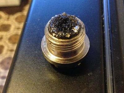

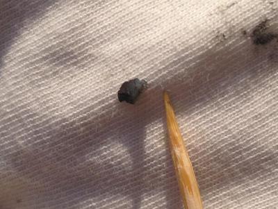

You are close to the edge on a go/no go retrofit with that amount of debris, particularly with that amount of ferrous material.  The synthetic material can come from multiple sources, including the wear pads on the chain tensioning paddles.
If your car was in my shop, this would be one of the cases where I would pull the IMS and open it up to see what is looks like before proceeding.
Agreed with John and I'm also concerned about the ferrous debris on the drain plug in such a short mileage, which means something is actively shedding steel.
Hi both, please see pictures of the debris from the pan, as said before I don't know when this came off last if at all, so this is not necessarily from low miles. I used the mag plug to pick up what was in the pan...
post-101407-0-92774200-1444153902_thumb.
post-101407-0-69151800-1444153932_thumb.

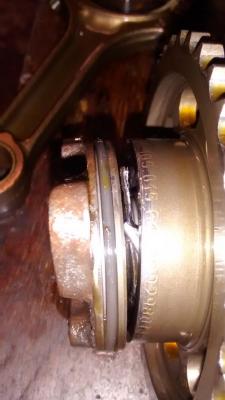

John, Ahsai,
Update time!
I've had the engine stripped down, went to see it the other night and according to the guy who's doing it it's all in pretty good condition, liners, cams etc. He's going to replace the crankshaft bearings while it's apart, but the offending item was......you guessed it!
How lucky was I that it didn't go bang?!
He wants to replace the whole shaft as opposed to just the bearing and I believe that means getting one from the US so I reckon it'll be the end of November before I get it back. I feel lucky to have caught it in time, and lucky to have found someone experienced to do the job, looking forward to getting back my almost spotless 996 with a new lease of life :)

You should go buy a lottery ticket :)
Replacing the whole shaft isthe proper fix since its also damaged by the disintegrating bearing.
