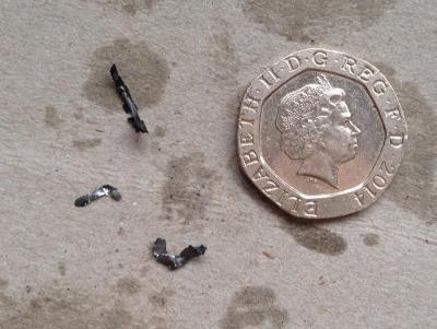

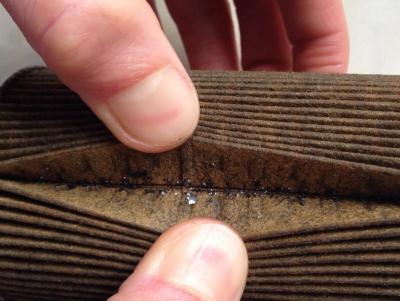

Just found these in the oil filter of my 1998 996 with 92k on the clock. They are ferrous, any ideas?
There are a lot of iron and steel components in these engines; valve springs, cams, crank, etc.  It could be from any of them.  I would plan on shortening your oil change cycles to monitor this,  and running oil  with as high ZDDP level as you can find.
Thanks again JFP for your knowledge and reply. Another user who discovered something similar was told it could be the iron plating from the pistons, 2 years later his is still going strong
. The indie who pointed it out to me used Mobil 1,0-40w, is that any good?
I wouldn't use that oil.  Look instead at Joe Gibbs DT 40, a very high ZDDP 5W-40 oil and plan on 3-4K between changes..
Many thanks JFP. As they are relatively cheap, would you recommend a magnetic plug too, anything else?
We have a lot of customers running the magnetic plug, which is a good idea.  I also like the spin on filter (100% filtration) and a FilterMag as well.

As I mentioned earlier, there can be several sources for ferrous debris, not just the IMS bearing.  Start up noise in these engine's is also common and can be the result of wear on the chain tensioner paddles, the chain tensioners them selves, and the lifters.
Prior to doing an IMS change, your tech should pull the sump cover for inspection.  If there is a substantial amount of ferrous grit in the sump, corrective measures are going to be required before doing the IMS swap, or the circulating grit will harm the new IMS which is lubricated by the engine oil.  If the sump contents are nominal, the IMS retrofit can proceed.  If you have not already done so, I would also add the LN spin on filter adaptor as well for better oil filtration going forward.
We do not advocate the use of oil additive's or detergents; you should be running a full synthetic which should do everything necessary to keep the engine cleaned out.

Not really, all these engine's generate some metallic debris, and not always at a constant rate.  That is why the use of a high quality oil and full flow oil filtration is so important.  The major point at this juncture is that you need to be sure there isn't a substantial amount of ferrous grit in the sump, which would negate the installation of the new IMS until after the engine is torn down to find out what is coming apart.  If the sump is clean, you can install the new IMS and you are ready to go.

I think it's a great idea to drop the pan and check yourself first and maybe post some good pics of the debris. Check out Jake Raby's video on oil pan reseal and just make sure you don't use excessive sealant.
Unless you open up the engine to clean out all the debris ($$), they may lurk somewhere and attack at a later time. I have no experience of the sealed bearing but it seems to be much more forgiving to debris. It's also a dual row, which offers good load capacity like your stock one.

Getting the debris and its source out of the engine is key to any path forward.  The problem with the grit is not just the IMS bearing, it is every bearing surface in the engine.  Full flow filtration, quality oil, shorten oil change cycles, and magnetism would be the best approach short of tearing the engine down.
