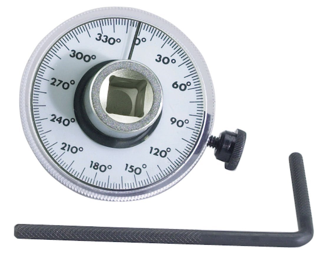

just to make sure I understand.
when you say +90 degrees...
torque bolt to 15ftlbs, stop, then continue for an additional 90 degrees?
Correct, to be precise, I use a torque angle meter (I have a digital unit, but you can get a mechanical unit off Amazon for around $14):
thanks once again. the advice & tips are really appreciated.
