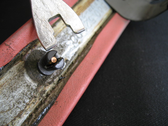

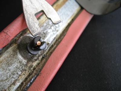

So I'm working to repaint my rollbar and decided to remove it.
Its actually quite easy to remove complete top assembly - just three bolts on each side where top meets rollbar. Rollbar is held in by just 4 bolts on each side (2 per leg)
Here's the proof:
Here is another way to paint it:
Here's the proof:

did the clips break when you removed the padding?
He removed the side windstop clips to paint. You can drill out the pop rivet, paint, than rivet them back on.

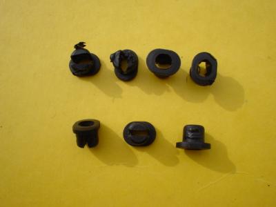

The rollbar padding is secured with round black plastic bushings that can also be reused.

Would I be right in thinking that when you replace them you insert the plastic plugs in the holes first, then push the pads on? I'm assuming this then opens out the plugs to hold it all in place?
Gorilla arms are a plus when removing the padding.
The black plastic bushings go back into their holes. Then you reinstall the padding. Just like you said.
If needed you can buy new bushings. But we reuse them.
