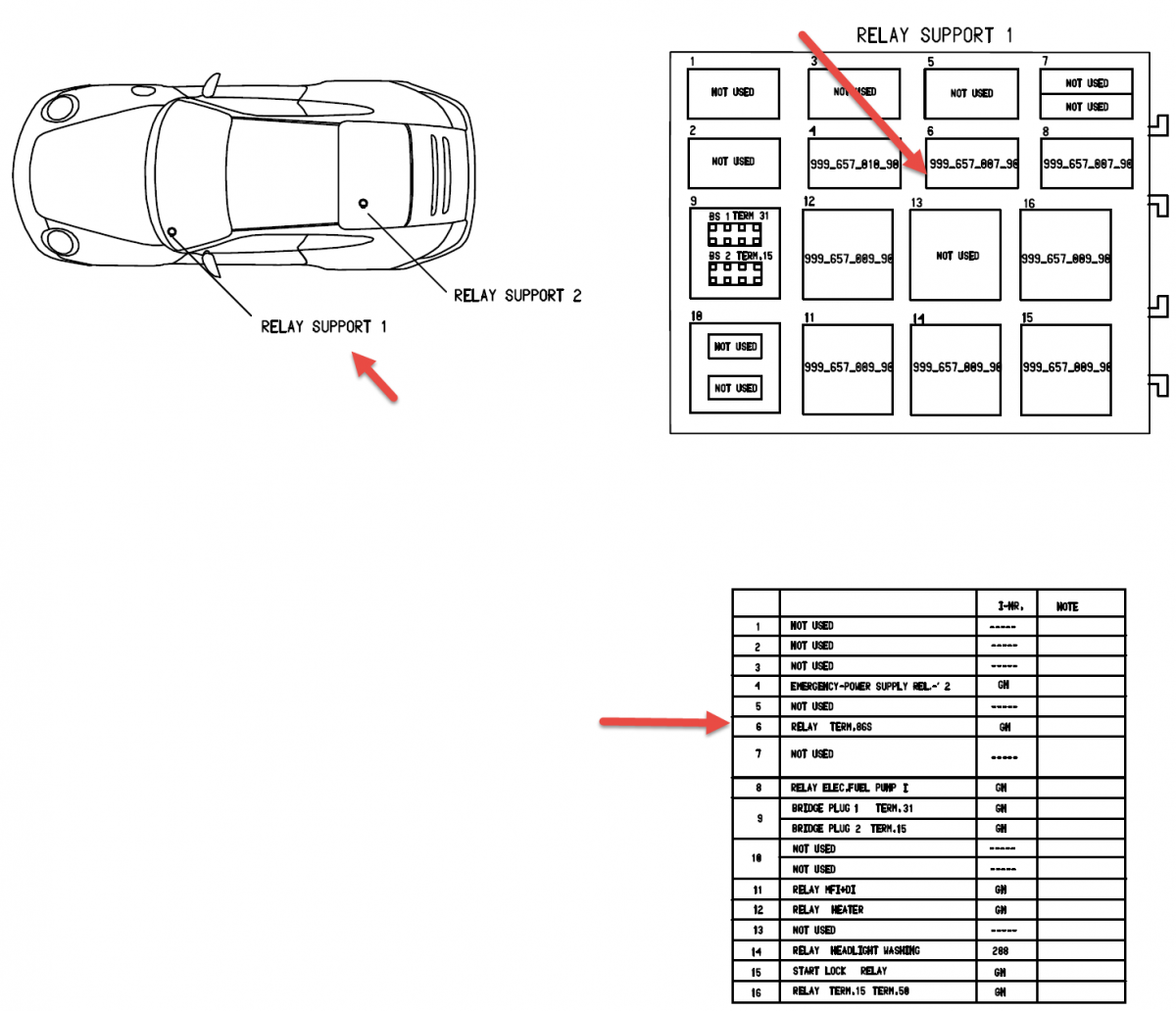

Hi Loren
Thanks for your response. The airbag control module etc function ok so I assume the Terminal 86s relay is ok. Do you know the location of Terminal 86 S so I can check the connections etc ?
Hi Loren
(click to enlarge)
