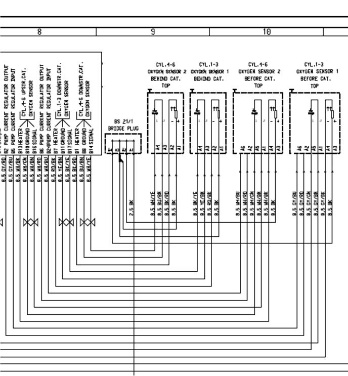

bump - there are some wires by the back right motor mount to the right of the airbox inlet.  Anybody have a clue what they are.  Anybody have a wiring diagram they can share?

Ahsai, this is for my eRam kit's eBox or electronic box that fools the spoiler warning system.  It draws less than an amp.  currently I pull +12V from the charging stud next to the oil filter.  would rather it connect up to switched power.
Ok, a gentleman from the TT forum just sent me the 02 TT wiring diagram. It's actually very similar to the N/A 996.
You can tap +12v switched power (add a fuse) from ANY black wire on ANY O2 sensor. The O2 connectors should be below the airbox and also on the right rear (rear of car) of the engine bay.
The black wire supplies +12v to the O2 sensor heaters. The DME provides ground to those heaters. The DME monitors the current going through the O2 sensor heaters via the wire AFTER the heater so whatever you draw (<1A BEFORE the heater) would NOT be seen by the DME if you tap on the black wires.
