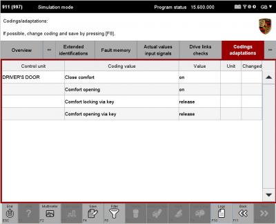

I think you should be able to code the Comfort features in the door control modules with a PIWIS tester.  On my 2007 Cayman I was able to set the windows to close with the remote when locking, but not open when unlocking.  I did this to prevent false activation.
post-4000-0-66253700-1434880652_thumb.jp
