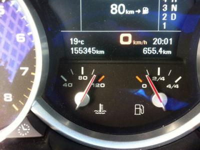

Decided to change the water pump on my turbo. Just in Case of a possible
Failure and because the temp went above middle on low rpm.
Today i take the car back. Driving in city Traffic . Stop and go. Temp went higher and higher
In Directon of red area. Switched on heating to bring temp down.
Called the mechanic and ask him if he refill the System with vacuum Equipment .
Any idea what it can be? Thermostat maybe?

Thanks for writing.
Radiator looks good. Coolant Reservoir is at the right level. I am just wondering how possible after having this new water pump Situation got worse.

When i drive home from the shop yesterday i didnt feel it at the beginning . Just when i enter the city and i had to stop on many Traffic lights i noticed the temp went up really fast

Cooling Fans running permanent on high speed when the temp is at 100 degrees
Are you sure it's not either the gauge or the temperature sender that's faulty?

This i didnt check but as the Fans are running full speed and under the hood its really hot i believe the gauge is ok.
As i wrote in my first post, just switching on heating on high temp makes the gauge going back to the middle
