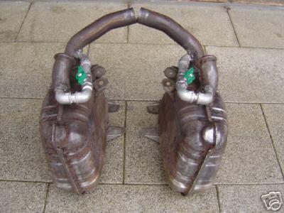

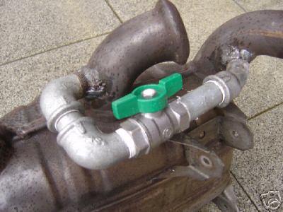

Interesting look I wonder how long those welds will last, or if it looks like it was done by some kids in a shop class (free labor anyone?).
The German ebay guy makes them for 996/986. He buys used mufflers then welds on the bypass pipes. A UK 996 guy on the Posche Club GB site bought the 996 version and gave it a good review. A UK Boxster owner has given the 986 version a good review. http://www.renntech.org/forums/index.php?showtopic=7325
Or you can go to Home Depot and get some galvanized plumbing fittings and make your own. The valve with the green handle is optional.

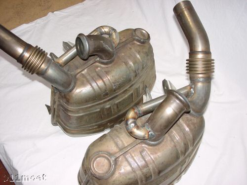

1999Porsche911 made his own. http://forums.rennlist.com/rennforums/show...t=221337&page=2
