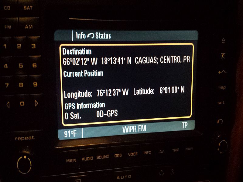

My PCM 2.1 on my 2005 Cayenne Turbo has on the information display, no satellites [Please check pic].
post-41858-0-47076800-1430347267_thumb.j
Firmware for both PCM and Navi DVD unit were upgraded, but no satellites. I checked it with the Durametric Pro but doesn't seems to fix the issue. Also I checked the connections from the antenna on the rear spoiler through the NAVI unit and it seems ok. I opened the GPS antenna and cleaned contacts overall, but still the same zero satellites results...
Any ideas? Thanks in advance!

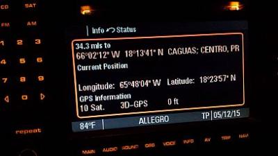

Finally SOLVED! :cheers:
It was the GPS Antenna! I replaced the unit in the Rear Lid Spoiler, but nothing! So I proceed to apply the 1-4-8 code and VOILA!  :jump:  :thumbup:  :cheers:  It worked!!!
post-41858-0-46632800-1431389903_thumb.j
So I guess that if you have NO Satellites and applied code 1-4-8 and still no Sats after check connections, then you got a bad GPS Antenna unit.

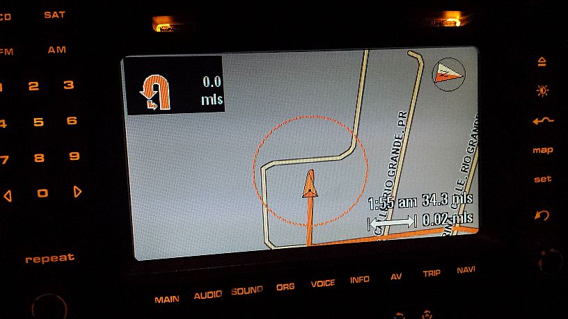

Finally if you install a new GPS antenna, then apply code 1-4-8 on the PCM unit to reset and PCM to recognize new GPS Antenna. Here are today's picture with finally NAVI Unit fully working. I still got the warning triangles on the SW versions, but at least I can use the NAVI now!

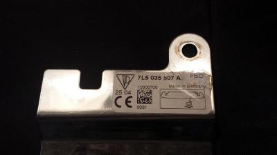

Here's the Volkswagen Part Number [7L5 035 507 A] as seen on the GPS metal base sticker....

I wrote down the numbers because Images, sometimes, are not displayed... I bought this item at www.ecstuning.com for around $79.00 [not including Shipping & Handling]
