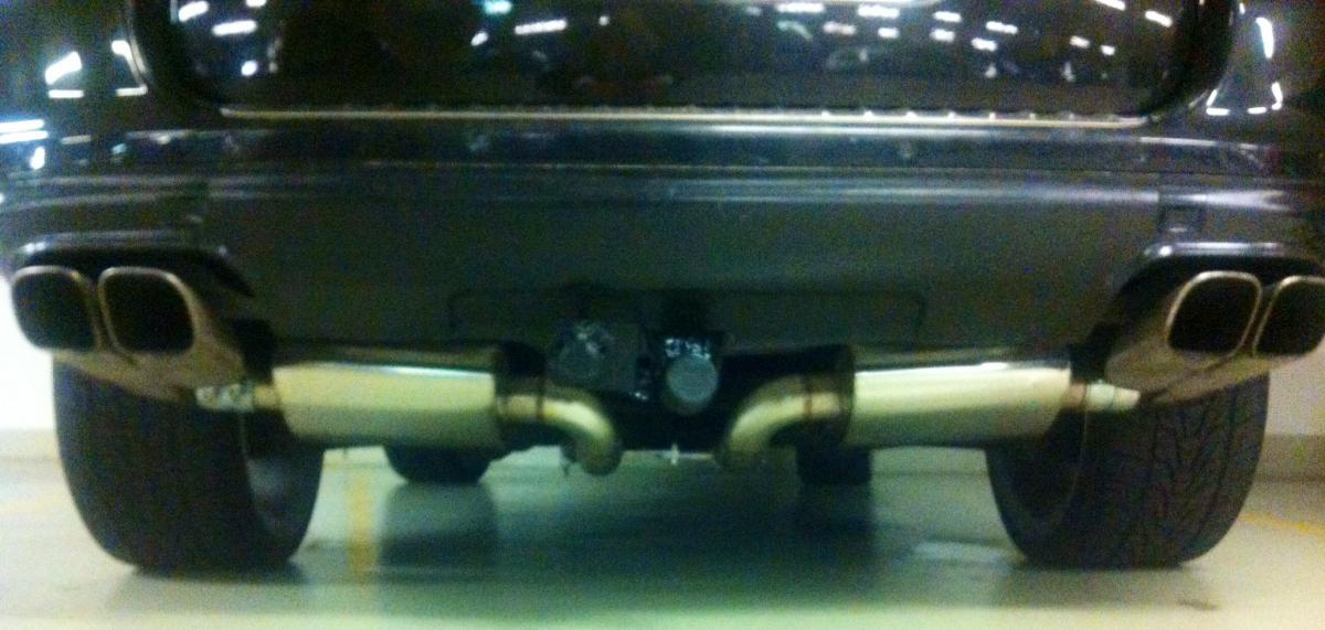

I wanted to change my original exhaust Muffler
For a sport Version which i bought long time ago.
I thought this is a DIY job but i had to stop this afternoon.
The Heavy Muffler is Hanging left and right in some
Kind of rubber mounting. Very hard to get it out.
Any idea?
Or i have to disconnect the bracket from
The body of the car?
post-77547-0-12869800-1429468859_thumb.j
Any idea?
Unbolt the mounting brackets from the car while supporting the muffler, they will then come off easily.
Thankx JFP.....
Deep seated rust. The bolts will not come of.
I need to destroy them maybe
Spray them with penetrating oil and let them sit for a bit before trying to remove them.
