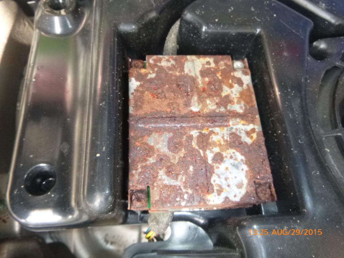

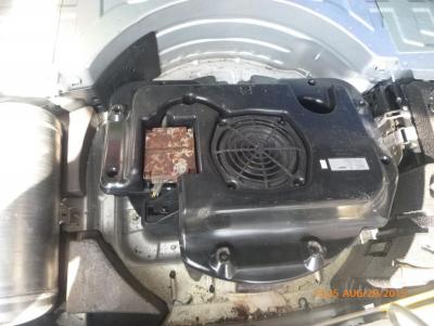

Well guess I'll be replacing mine too. I've been noticing my music sounding thinner and thinner week by week. Today I decided to investigate and here we go! Anybody have a working sub or sub amp you'd like to part with?post-77842-0-32848000-1440875190_thumb.jpost-77842-0-98264500-1440875193_thumb.jpost-77842-0-58966500-1440875198_thumb.j

Old post I know but I finally got around to installing a new amp and the sub still doesn't work. Does the new amp need to be coded to the car? Thanks in advance.
okay update. took everything apart and reconnected the new amp. still no joy. did the 1-4-8 reset and the new amp works just fine. just fine enough for me to discover the subwoofer is blown too! gotta love it!
