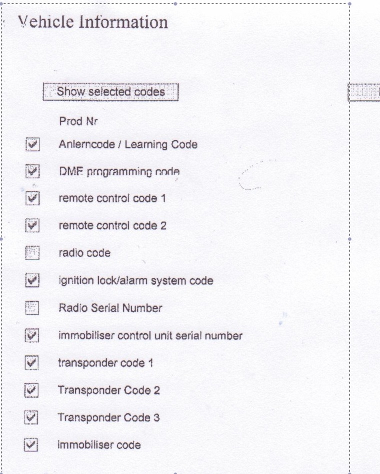

Yes the key has to have a 24 digits code that you will need. But the IPAS code can only be found at the dealership. If you do a search with "IPAS code" you will found some Porsche owners having difficulty to get them But according to Porsche North America they have to give it to you. The IPAS code are a series of programming keys (numbers+ letters)  to enter in the different system specific to your car: Here's a picture of what you should get…. Some people got them easily just by presenting a proof of ownership to the dealer. Picture show the code title but I removed the keys which are numbers and letters besides every single system related to….

Forgot to mention before you start the process you also need all the keys related to your car….
