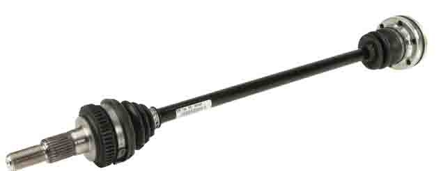

I have a '99 996 with 110K miles. When do I know to change the CV joints?
Also, the parts diagram calls for two joints per car (inner). What about the outer joints?
Watch for noise or vibration, or torn boots on the CV joints.  There is a CV joint at both ends of the axles, under the boots:
