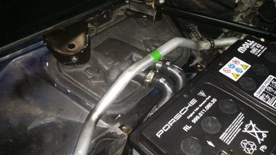

few days ago I decided to fix the foam flaking over the car ventilation and the lack of hot air by accessing the air mixing flap through the heater core.
To my surprise it seems not possible to remove the heater core easily in the C4 because an aircon pipe crosses over it (see attachment). I'd would guess that I'd need to remove the offending pipe and the recharge the aircon but it would be great if anyone with the same experience has some input about it.

hmm. ...I have a c4s and did the heater core last summer. I don't remember that pipe being in the way...if it was, it was easily moved to the front as I had no issues doing this repair. very easy
I'll take a look at the car tonight...
Yeah, you're right, mine doesn't have that.
is it pretty solid? any brackets/braces you can undo to give you an inch or so?
It is bolted on both sides but probably full of freon so I don't wan't to mess up with it much.
I guess if I take it out I'll make a mess / will need to recharge the aircon.
I am not sure if dealing with the aircon is as "easy" as just let the gas escape and then get it recharged or some other precautions need to be taken
