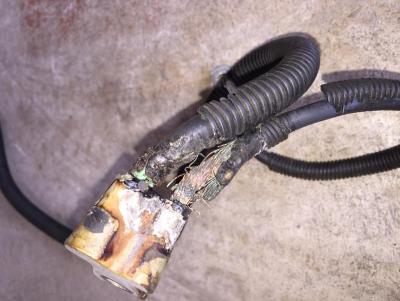

Here's what the old cable looked like.
Yikes! Glad you got it sorted.
What do you think did that to your cable? 'farmer boy' indicated that he had a defective starter that he replaced and looking at the photo of the terminal you posted, looks to be the end at the starter. Do you think your starter has a short that caused that? Corrosion? Engine Temperature?
I wish I knew. From all the pics I've seen, the corrosion on mine looks consistent with most of the other failed cables out there. It's likely a heat/crappy cable quality issue.
Wow!
As an aside, I read that a faulty starting circuit or starter motor can even cause a host of CEL issues as well (P0341)...the corrosion on that cable would explain alot...
Hope it does not happen again for you!
I still don't understand how it can corrode so badly as if it was attacked by salt water or something acidic. The lug locates in mid-air right above the engine case. I wonder if there's any corrosive vapor in that area but I can't think of any such source.
