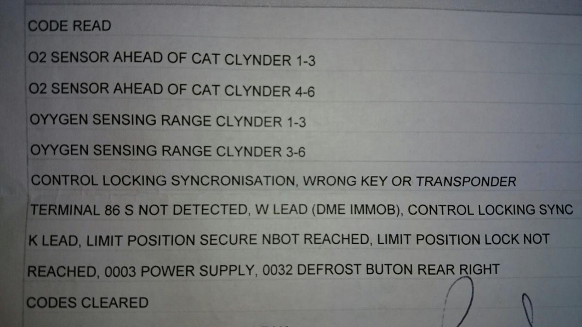

Thanks for the reply.
Haven't tried cleaning idle stabilizer yet - will give it a go. Tried a new fob battery but no improvement.
I had the codes read and are below. I'm thinking fuel pump, fuel pump relay or O2 sensor? (But it didn't give a sensor code?)
Many thanks.
