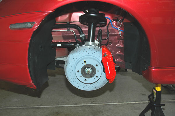

Here is what the calipers with 76K miles look like after a Pre-Concours refresh

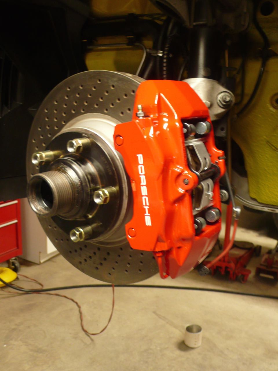

Before and after photos from a project a couple of years ago.  I got my paint from Tirerack.com Press Here and the decals from MaxSpeed Motor Sports Press Here
Touch them off with a couple of thin coats of Rust-Oleum crystal clear enamel spray. Wallmart or Home Depot (Press Here) for less than $4.00/can.

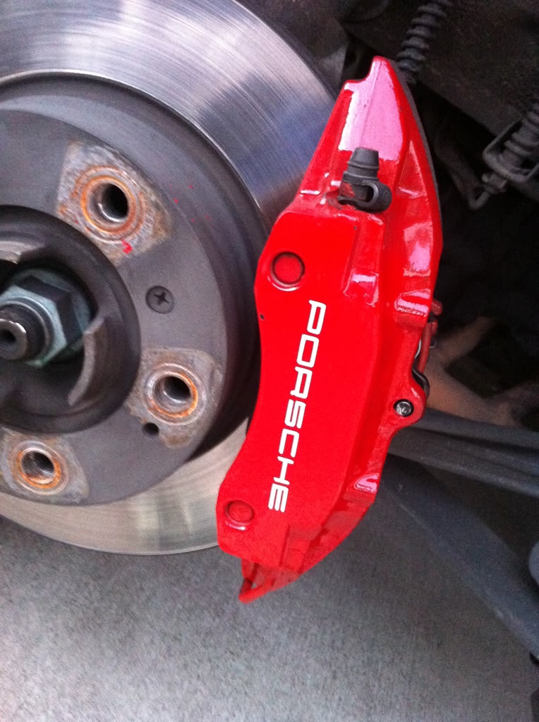

Caliper lettering update...  I waited for 4 weeks for my supplier to get the PORSCHE decals for my brake calipers, after vague responses on a ship date I went to the internet and bought a set on line.  What I ended up with is 4.3" long die cut vinyl letters.  I believe the letters were originally 4".  That was ok since my car is not concours...  Actually I liked the longer lettering strip and the die cut letters went on nicely.  Albeit they can be tricky to install.  I had one of the letters leap off of the mounting sheet and stick to the caliper, I carefully removed it and repositioned it on the mounting sheet.
I used Dupli-Color VHT clear spray giving the face of the caliper two coats, looks great...  I bought the lettering from a Florida based internet vendor (not from China), they furnished 4 lettering strips.  If I was to do it again I would order 5 strips, 4 to use, 1 to lose.  I might add that this vendor referred to his lettering as decals, but they were die cut letters.  I'm ok with that, but you should know what you're getting if that is important.
