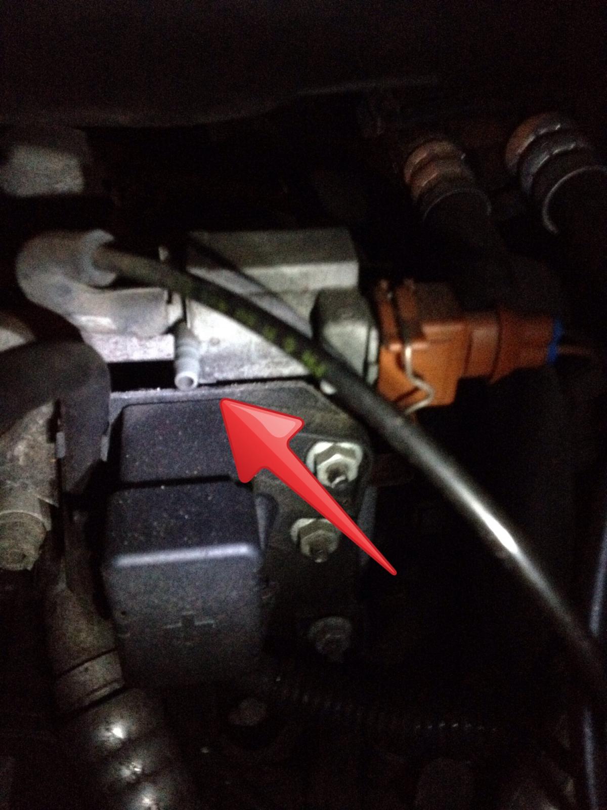

I have a 2001 996 3.4L C2, I've only owned the car for a couple of weeks. Today the engine check light came on with no obvious symptoms. I have a very basic code reader and the fault codes were P1128 and P1130.
After a search of Google (and a moment of scaring myself silly with air oil separator story's causing catastrophic engine failure) I started to look for the cause maybe a possible vacuum leak.
There is a component on the o/s of the engine compartment suspended just above the engine. It has one hose going to it and a second hose tail that looks like it may of once had a hose on? I have attached the photo. Maybe somebody could advise me what this is and if there should be a hose attached?

That looks like it may be part of the sport exhaust system.
If so, then one side should go tot he intake (for vacuum) and the other side should go to a "Y" connector that splits into two lines - one to each vacuum controlled valve on each muffler (one on each side).

It looks like someone removed the PSE and did not properly shutoff the vacuum line(s). As RFM said those should be properly plugged to prevent vacuum leaks (and fault codes).

I have blanked off the unused vacuum hose tail with a diesel injector rubber blanking plug and cleaned the MAF sensor for good measure. Done a few miles and no sign of the check light.

To check if the unplugged module was causing the vacuum leak, remove the plug and look at the MAF reading and fuel trims (FRA/RKAT)then plug the hole, If the Maf reading goes up and the RKAT/FRA readings go down then that was your vacuum leak.
