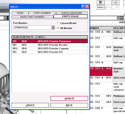

I have new set of wheel caps a friend gave me. I am trying to determine which model it will fit.
The part # is 7PP601152A. They are painted in GT silver with the Porsche shield logo, non-concave and the dimensions are od = 76 mm and id is aprox. 60 mm.
Thanks!
Thanks JP. Is it possible to get access to the PET application?
 You can probably find a copy for sale either as a CD or download online somewhere.
