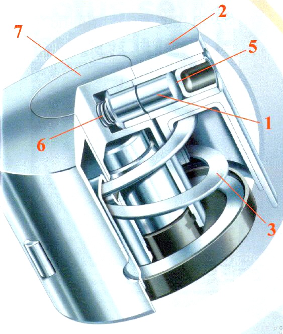

the lifters....should I be able to push the inside "piston" with relative ease? I believe these are activated with VC+.

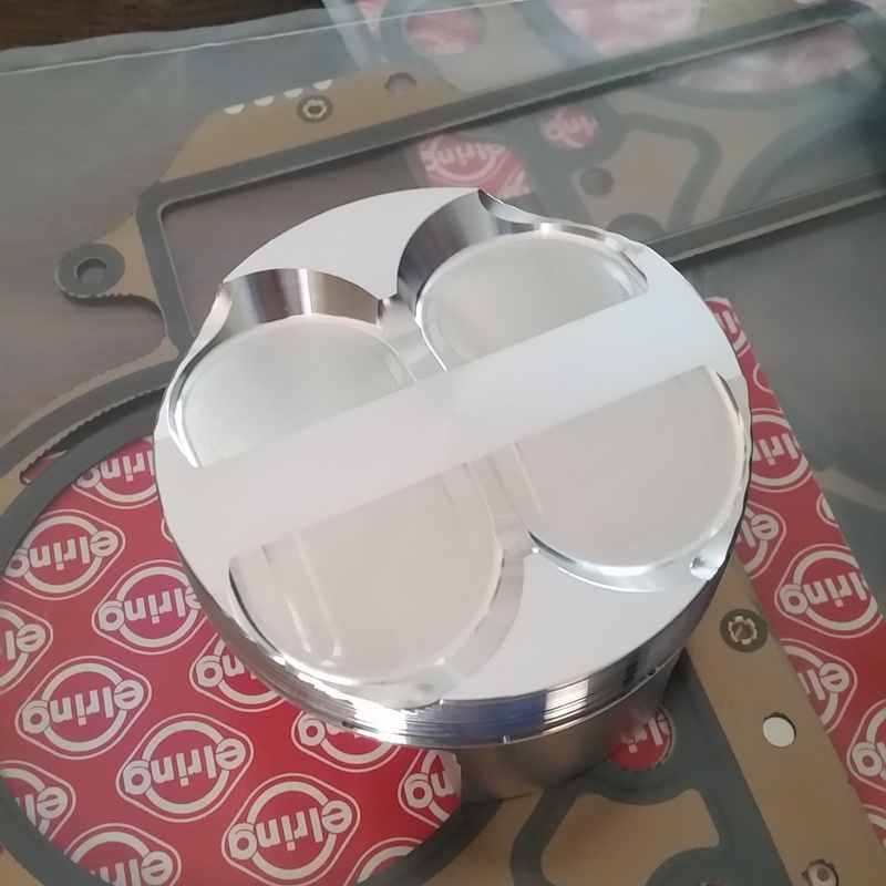

I'll leave all that to LN Engineering. looking at this right now:
http://lnengineering.com/products/watercooled-cylinders-pistons/porsche-boxster-cayman-and-911-model-years-1997-2008/36-911-nickies-inc-96mm-fsr-je-piston-set-inc-rings-pins-clips.html
may go from a 3.6 to 4.0. still doing some homework. it's the same price, so why not.
I saw they have the 3.6->3.8L option but didn't see 4.0. Is it off the menu? :) Have you decided? If you go for cc increase, will you need new injectors and new DME tune or pretty much you can reuse everything stock (other than the pistons obviously)?
I don't think so. maybe I'm one of the last?? I'd be curious if so....they have my deposit already, so I hope I am getting the 4.0. lol
from what they told me, the porsche ECU is supposed to be able to compensate for the added displacement & my injectors are fine.
still looking for an answer. some, I can push down with a pencil (eraser end), others are pretty tough to do.

The lifter should have a locking pin (#1 in the diagram) http://www.renntech.org/forums/uploads/downloadedimages/cs_variocam_plus_003.jpg
My understanding is with no oil pressure the pin is not engaged (pushed by spring #6) so you should be able to push in the center piston. The presence of oil pressure should move the pin sideways to lock the center piston to the outer lifter?

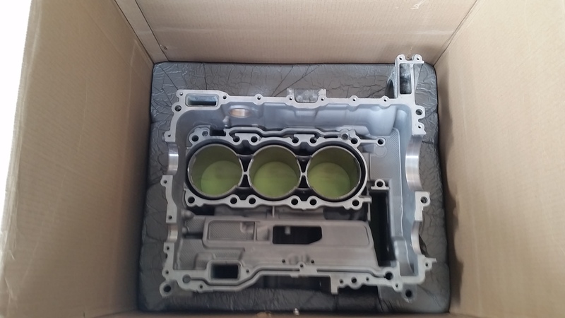

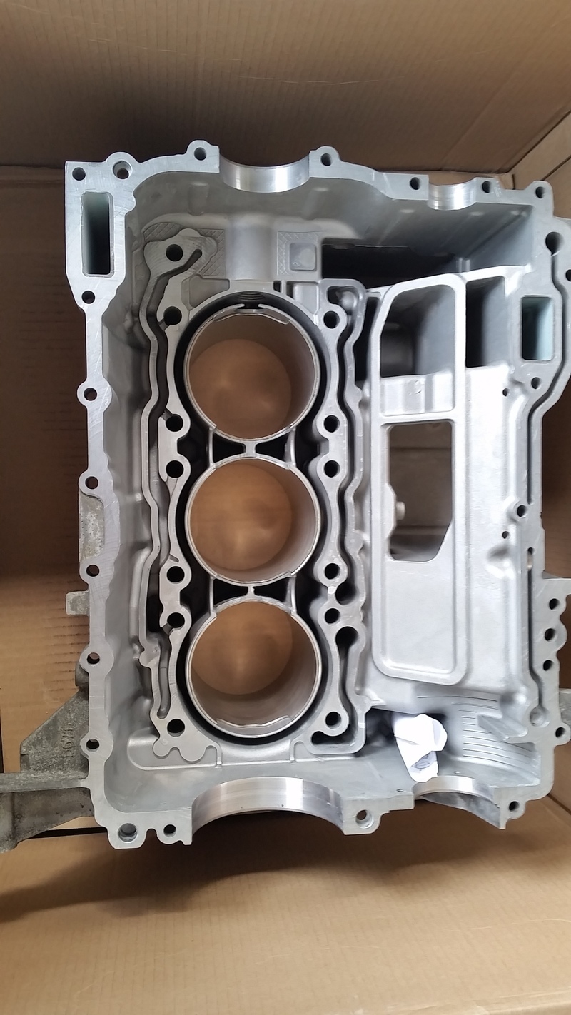

page 2 (on tapatalk) show the heads when I pulled them. I didn't snap pics when they came back from the engine builder/cleaner. the heads vacuum tested "excellent" according to them and should be good to put back in.
edit: just realized what youre asking. no, don't have any shots. need some?
Edited by AWDGuy

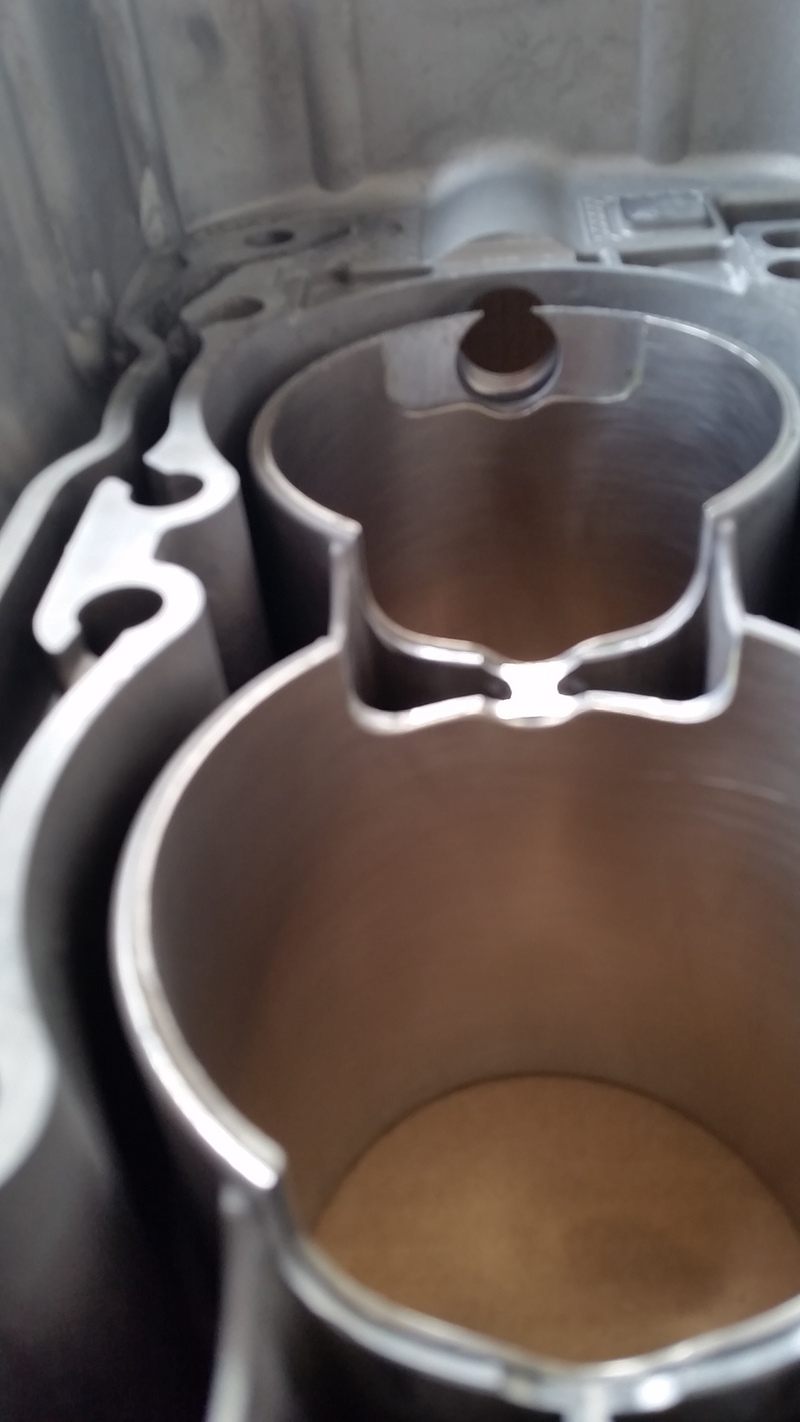

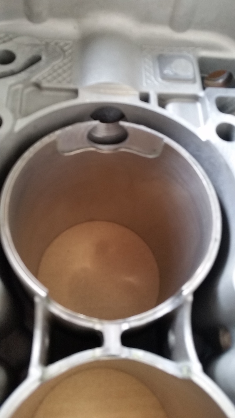

Sorry I wasn't clear. I meant if you have any shots of the new case that shows the other side (the TDC side) of the case.

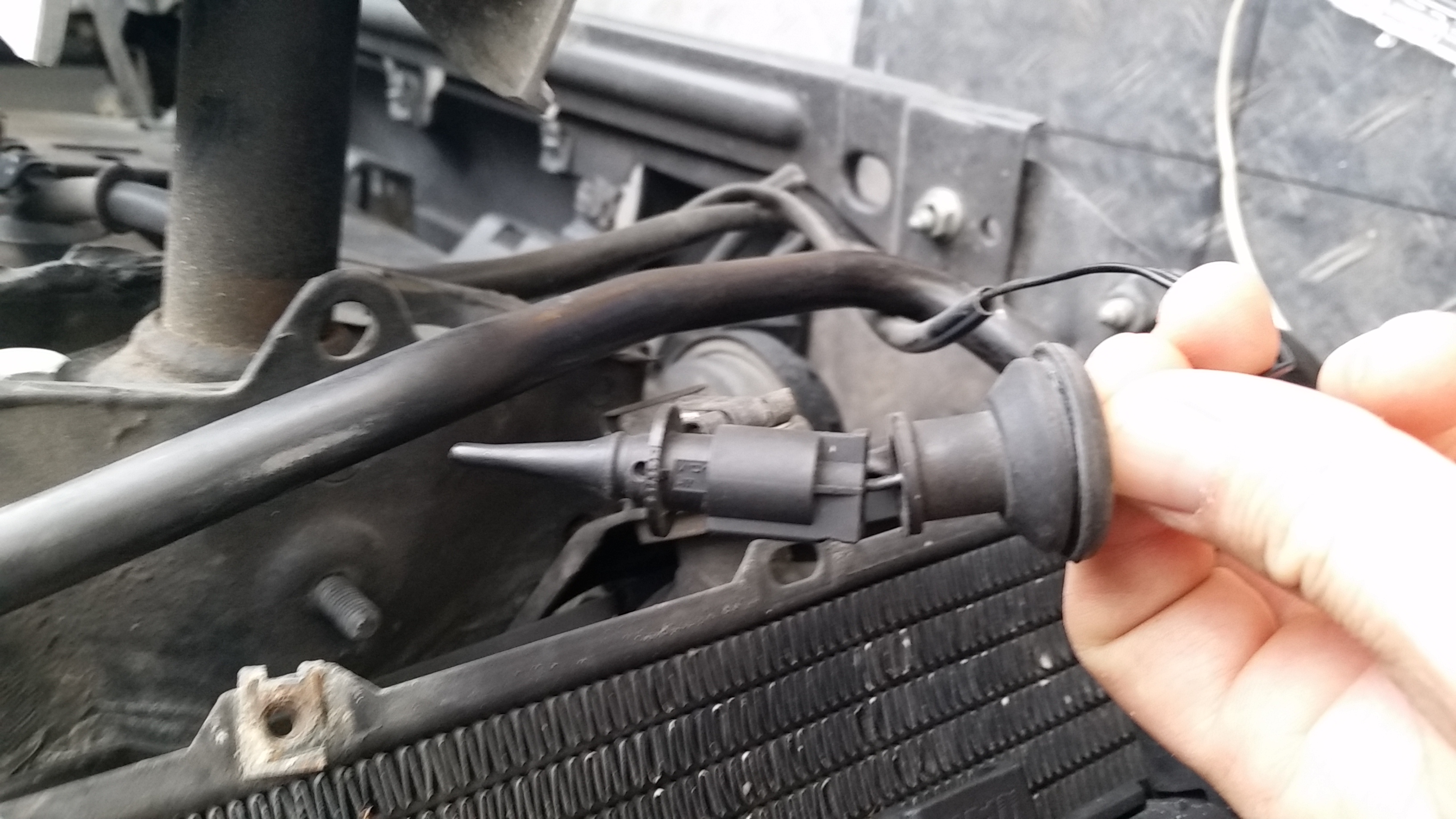

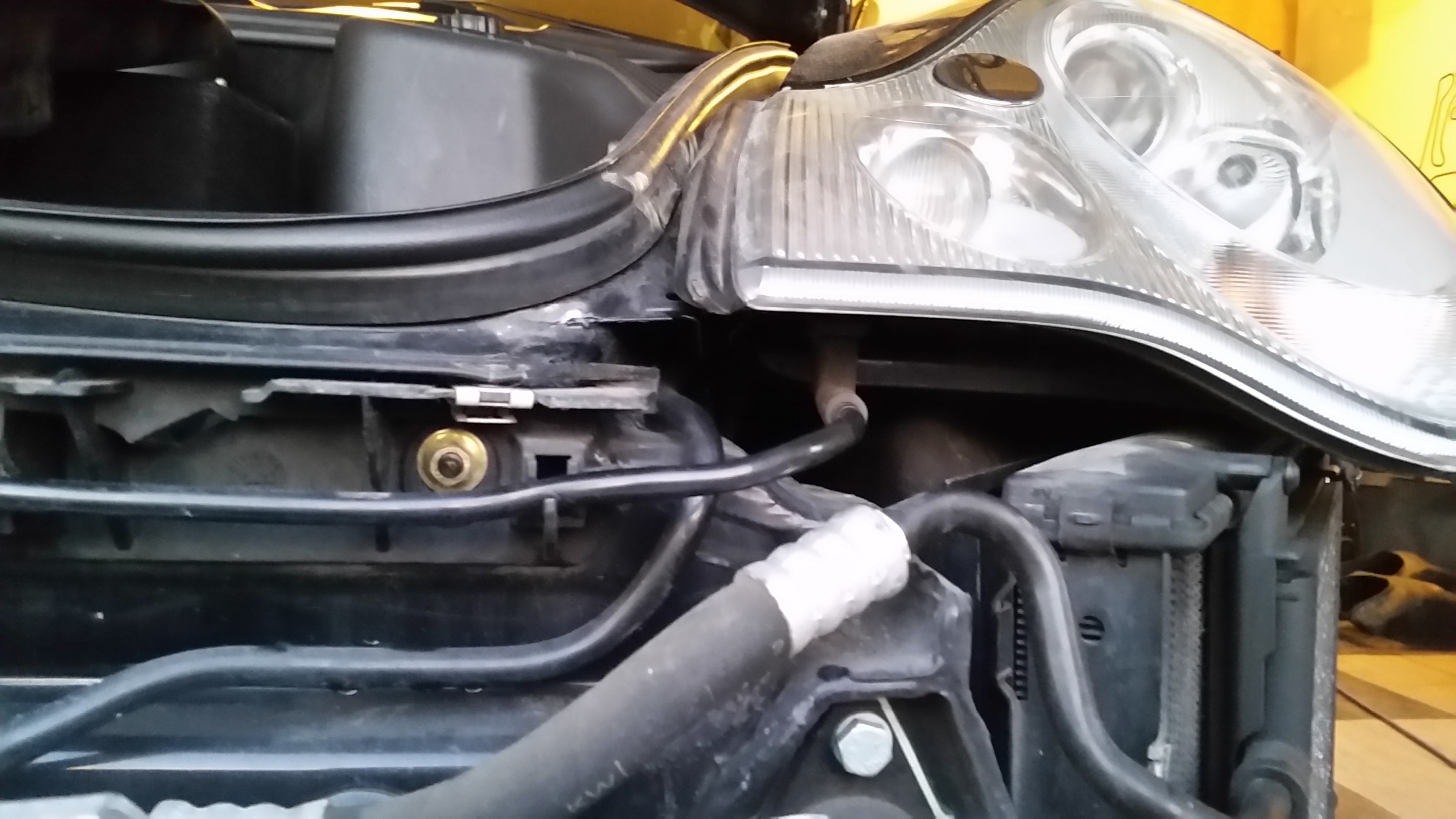

also...I see the headlight has a vent hose. the passenger side looks like is missing. I imagine there should be one?
