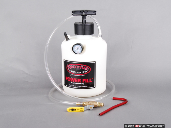

Motive also makes one for those uninclined to build one themselves:
I had thought about picking a Motive bleeder up, but it looks like I'll have to take my 996 somewhere that has the proper scan tool to flush/bleed my brakes, as my car is equipped with PSM. Doh! Edited by thewheelman
You only need to bleed the PSM and ABS if the system has been open and gotten air into it.
I've been using the motive product for many years - a worthwhile investment for any car or shop (IMHO).
