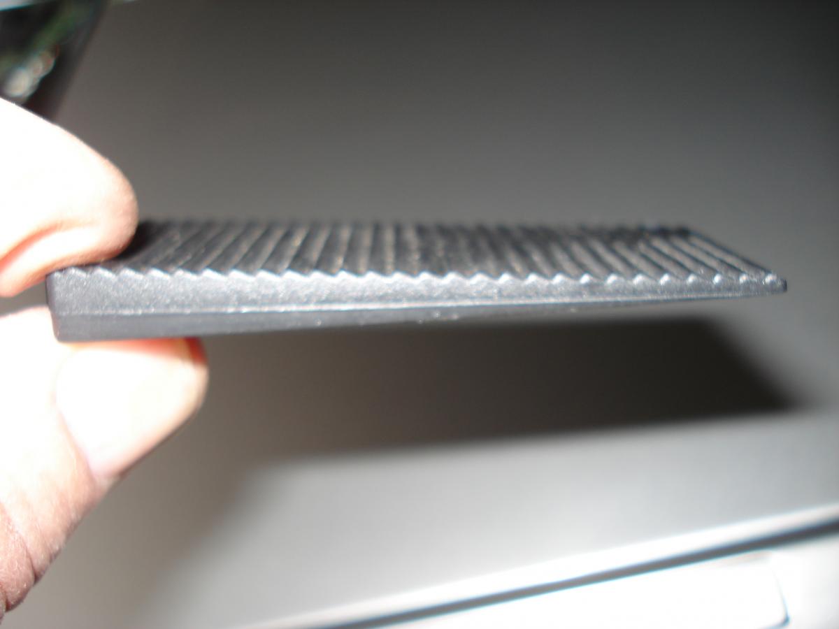

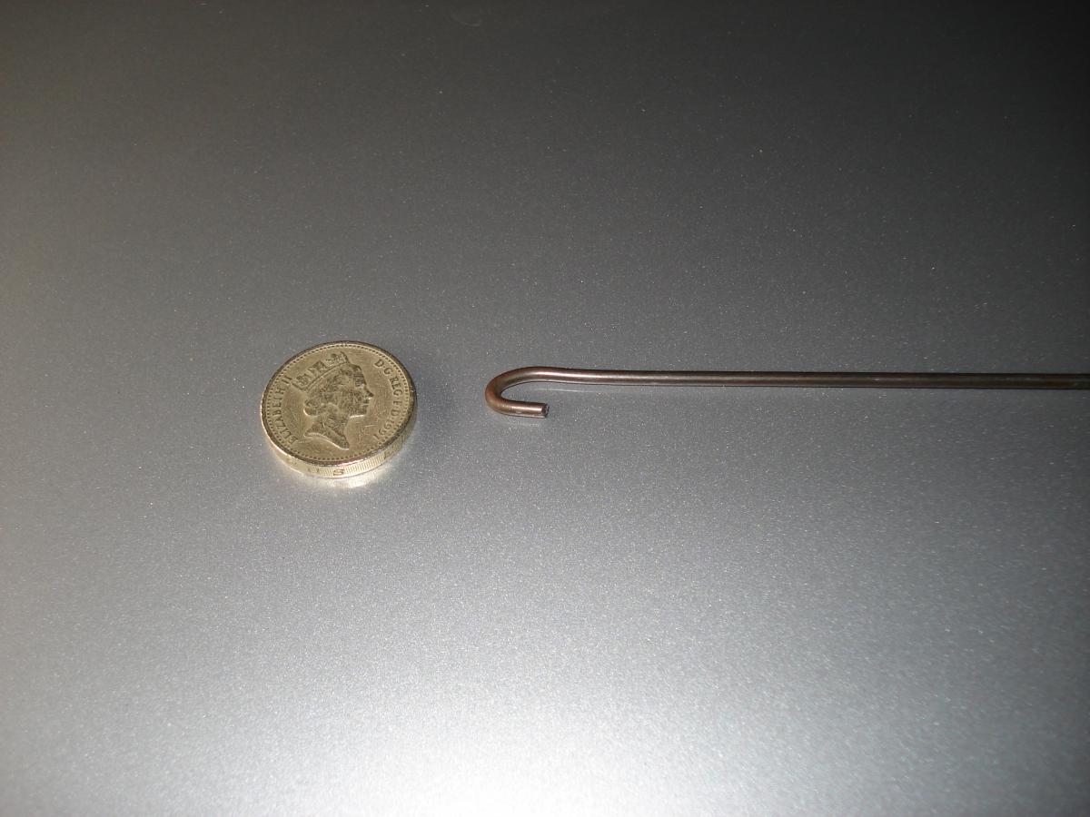

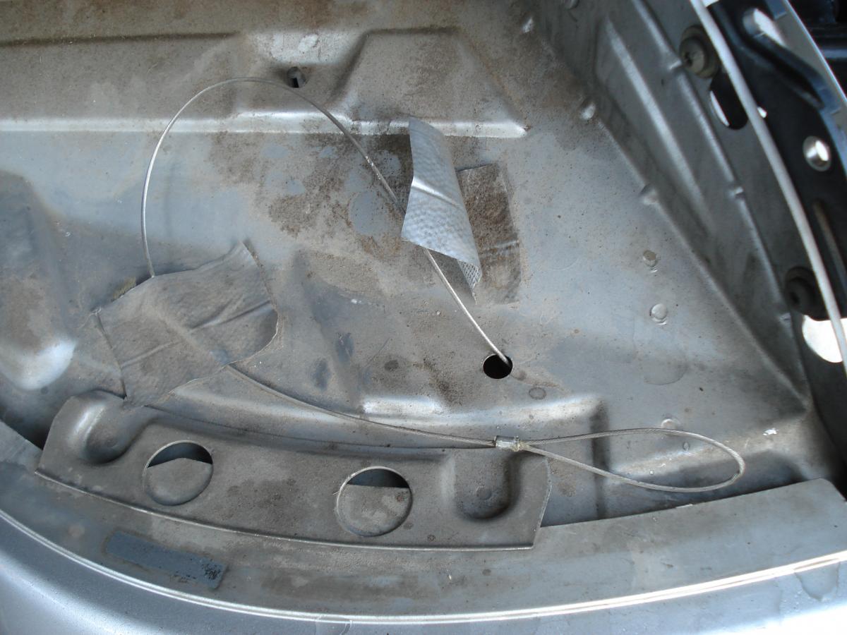

A few pics that might help
The first pic shows the hooked end.
The next shows the type of wedge - you could use cardboard or timber.

The final pic show the wire with the light cluster removed.
post-86549-0-17826800-1419937940_thumb.j
post-86549-0-15289300-1419937969_thumb.j
post-86549-0-08282800-1419938008_thumb.j
post-86549-0-46227400-1419938048_thumb.j

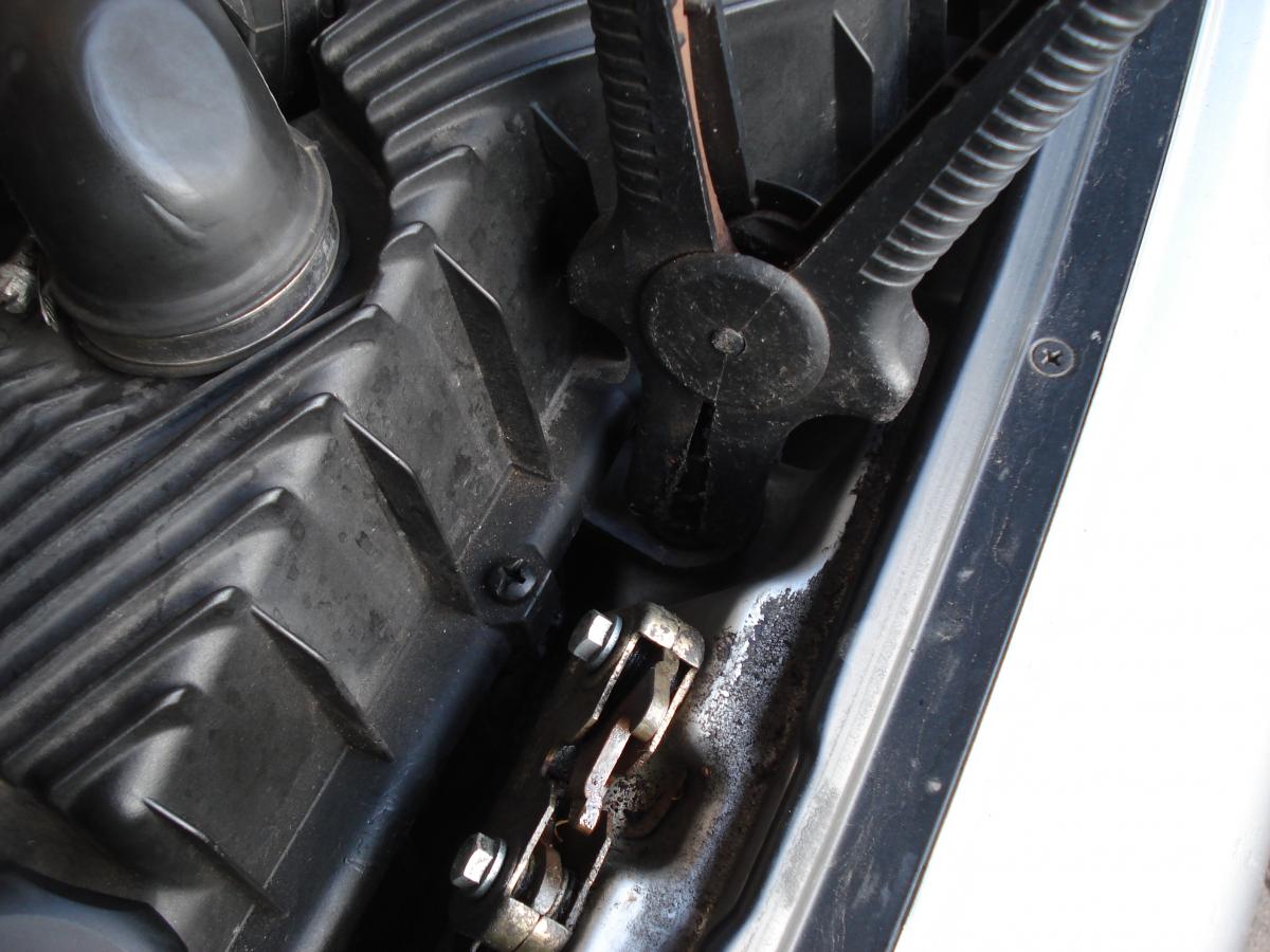

Having opened the lid jump leads can applied to the jump posts. These are shown in the
following pics. The earth jump post (black lead) is near the catch. When the lid is opened
the alarm will go off if there any life left in the alarm battery.post-86549-0-39296500-1419938459_thumb.jpost-86549-0-74709400-1419938494_thumb.j
