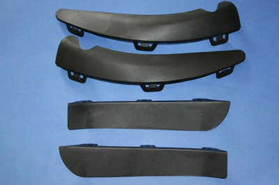

Remove the following:   1.  Remove the front bumper - you can Google, “remove 996 Porsche front bumper” and find several sites that explain the process.  2 people can do it in 15 minutes.     2.  Remove the front fender liners on left and right fender wells.  There’s one plastic rivet under the horizontal area of the liner that is hidden in a recess.  Tough to see and can be tougher to remove.  A little penetrating lubricant can help, you want to remove the center pin in the rivet body.  The re
