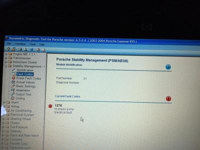

Hello , i recently purchased my 04 Cayenne S and first 2 weeks i had intermittent Abs/Psm failure coming on the dash , now its on all the time :cursing: . If i try to reset the codes with Durametric , they come right back on without even touching the pedal.  Please if anyone can advice :help:  .

Pretty self explanatory, P1276 is an electrical fault involving the pump and control network for the PSM and ABS systems. Take a good look at the wiring around the PSM hydraulic unit, I think there is a TSB on moisture entering the harness connector at the PSM.
Thanks for the response. I will check :eek: on the connections. Could the module have gone bad ? any other ideas if there is no trace of moisture at the connector?
It could also be an electrical fault in the pump itself.
Hello I have a 2010 cayenne and I have the same issue but I think I know what will be the main problem, a couple weeks I notice water on the carpet at the passenger side I thought that it was the condensation mustuire coming from the ac under the passenger side dash but after a exhausting search I found out that the problem comes from the ducts full of mudge exactly located it on top of the tire and under the abs pump I cleared it from leafs and all kind a dust literally 2 litters of water cane out problem fix! Finally but I’m suspecting because of that the electrical connections may become wet causing the 1276 code anyway I hope this help and probably this week I will dissemble the whale thing in other to check it if y fix it I’ll get back with more details good luck guys
