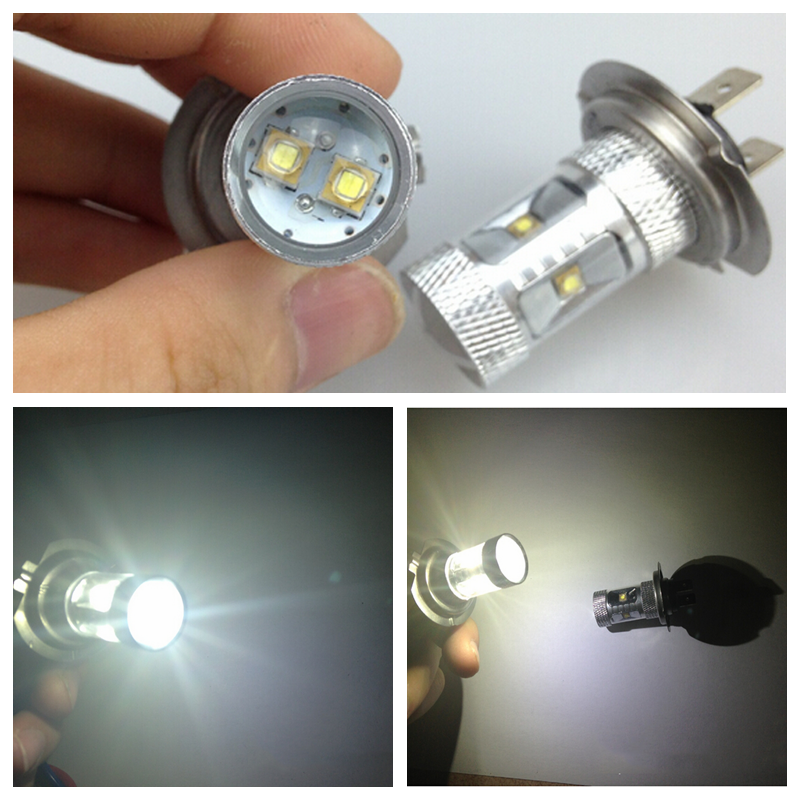

Yes, I did.  I used a 35 watt 5000K kit.  Unfortunately, it was too hot.  You could feel the heat on the lens and I have no doubt it would discolor the lens over a short period of time.  I switched to LEDs and after trying several landed on the below one.  There are numerous ones for sale with this design.
http://www.ebay.com/itm/281495906699?_trksid=p2059210.m2749.l2649&ssPageName=STRK%3AMEBIDX%3AIT
