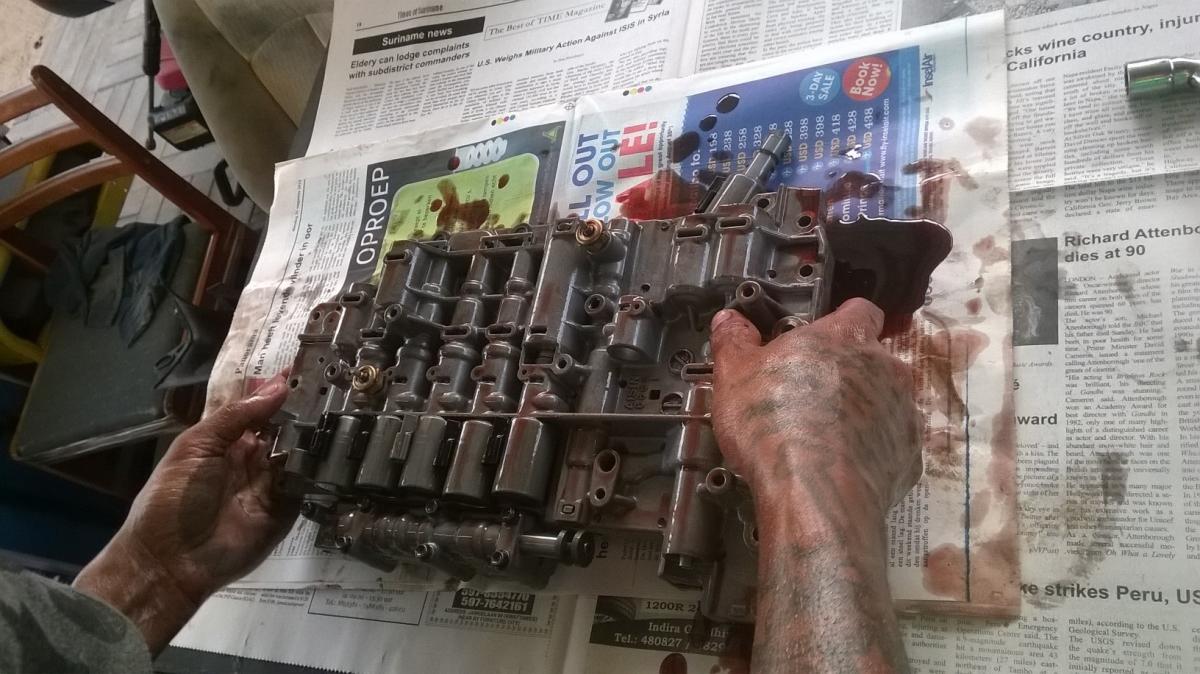

I have got my pan out. Transgo kit will take two more week to arrive so i'm going to try it without. Tomorrow i'll get the valve body out. Clean them solenoids and see if anything changes.
Valve body cleaned with carb cleaner, contact spray and WD40. Solenoids tested and they seemed fine. Valvebody back in place pan also. Monday i'll get the new oil in. I have 6 quarts of Aisin T4, can i add some Toyota T4 which should be the same?

Did you take all the valves out also? Also I'm unsure if cleaning the outside of the valve will help any. The bushings in the solenoids get dirty and gum up which makes the solenoids stick until pressure over comes it. With the transgo kit you clean those bushings out. Which I think might be the main problem.
I did get the solenoids but i did not get the valve body open. Car has less then 50k miles so i thought i'd give it a try. Like i said if it doesn't work i'll go for the transgo kit.
Ok, i went to take it for a spin. Smoothes real good and quickly the problem was going from 3th to second, that completely disappeared. Now It happens when shifting from 5th back to forth. Upshifting also a little bit. Car shift a whole lot better overall but the problem still is there. Just that the shifting problem shifted to another gear. Shall i go for the Transgo or should i try it again? This time opening up the valve body.

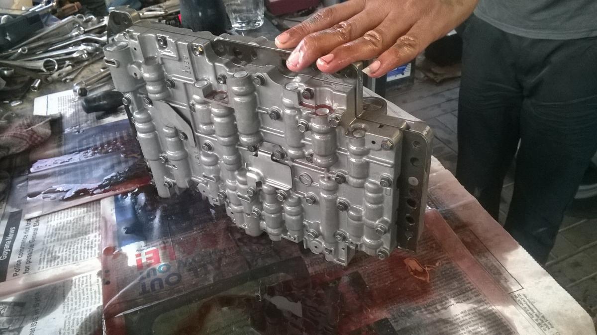

Ok my kit arrived today. Comes with a manual. Mine only hard shifts from 5th back to 4 when hot so it seems i don't have to mess with the solenoids at all.  I'm loving this kit already. I already did the first 2 steps. Tomorrow i'll finish it off. Quite excited :) For those who are still doubting: valve body repair can be done at home by any backyard mechanic.
@ Krunkymonkey: Thanks for your help!
Valve body back in its place so i took it for a huge drive. Shifting very nice now. I didn't reset the tranny all i did was drive. In the beginning it was acting a little strange on kickdown. Overall i'm very happy shifts like new!
