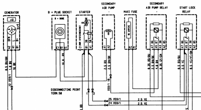

Anyone knows where the 4.0 mm2 brown wire to the 40A maxi fuse for the secondary air pump is getting +12V from?
Thanks Loren,
I think I expressed myself wrong, but as far as I could see in the relay holder, the power to the secondary air pump is coming from the secondary air pump relay (relay 10) and the power that is supposed to feed the relay is coming from the maxi fuse. Where does the +12V to the maxi fuse/relay coming from/connected to? Directly from the battery/starter? As far as I remember it was a thick brown wire about 4.0 mm2, but I could remember wrong...

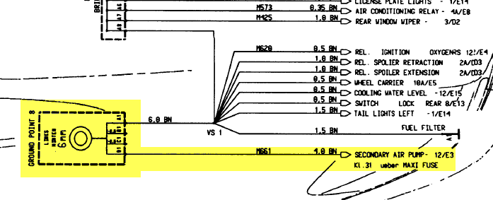

Ah I see:) Where is the wire A2 from maxi fuse grounded?
Thank you Loren:)
Excellent info:)

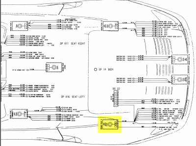

Where is ground point 8 located? Found a picture of it when I googled it, but it was hard to see...
