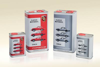

what about this?  a bit more expensive, but the cans sure look nice.
Unfortunately, I have no reference as to its ACEA ratings or ZDDP levels, and it is expensive.  I think you can do better elsewhere.
