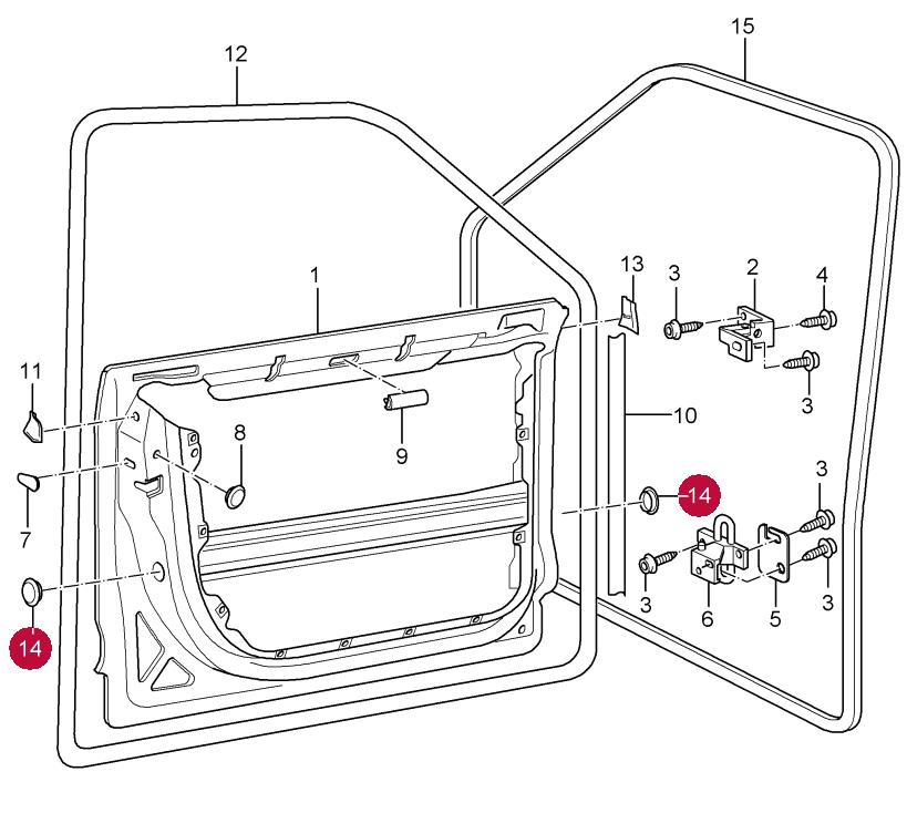

I do not see any "drain" on the doors per se... but there are plugs in each side of each door that you should be able to get a tube in and suction out the water.

The picture in post #5 shows two different seals.  The one that is wet is NOT the seal I am talking about.  Looking at that picture from post #5, you are interested in cleaning the junk out of the lower of the two seals.  The black part beneath the silver in your image, it is quite literally the lowest point on the door.  You are getting water higher up the door because the drains at the lowest point are clogged.  Contrary to what most people think the window seals are not meant to be completely water tight.  They leak a little.  So it is very normal for the inside of the door to get wet.  The trick is for it to have a way to drain out.
