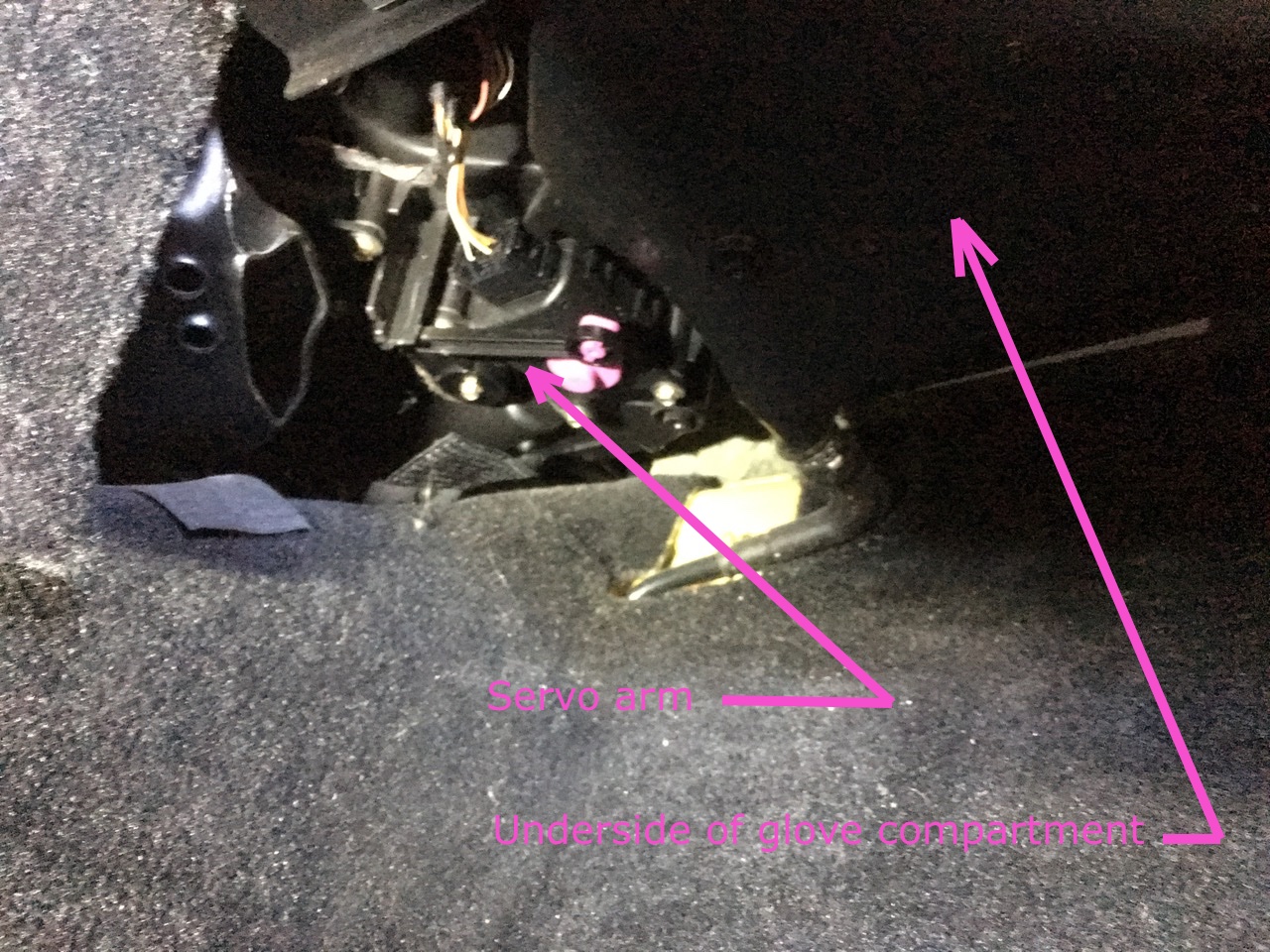

Anyway, I'm into the removing the A/C-heater door.  I wouldn't be doing it, but my A/C is slow to cool so I hope this will fix the problem.
Question: Emmett says that the servo arm is under the console, does he mean forward of the console under the dash.  If that's the case it would appear
to me that you have to remove part of the radio stack?
Update: To access the servo motor and arm you need to remove the foam pad that covers the area under the dash and forward from where the glove box ends.  There're 3 slotted plastic screws that are located on the rearward edge of the foam covering.  You need to be able to stand on your head for this.  So far I'm not sure I have the 7mm nut that removes the servo arm.  I've got to get my inspection mirror for a better look.  Getting close, no cigar...
Mitch

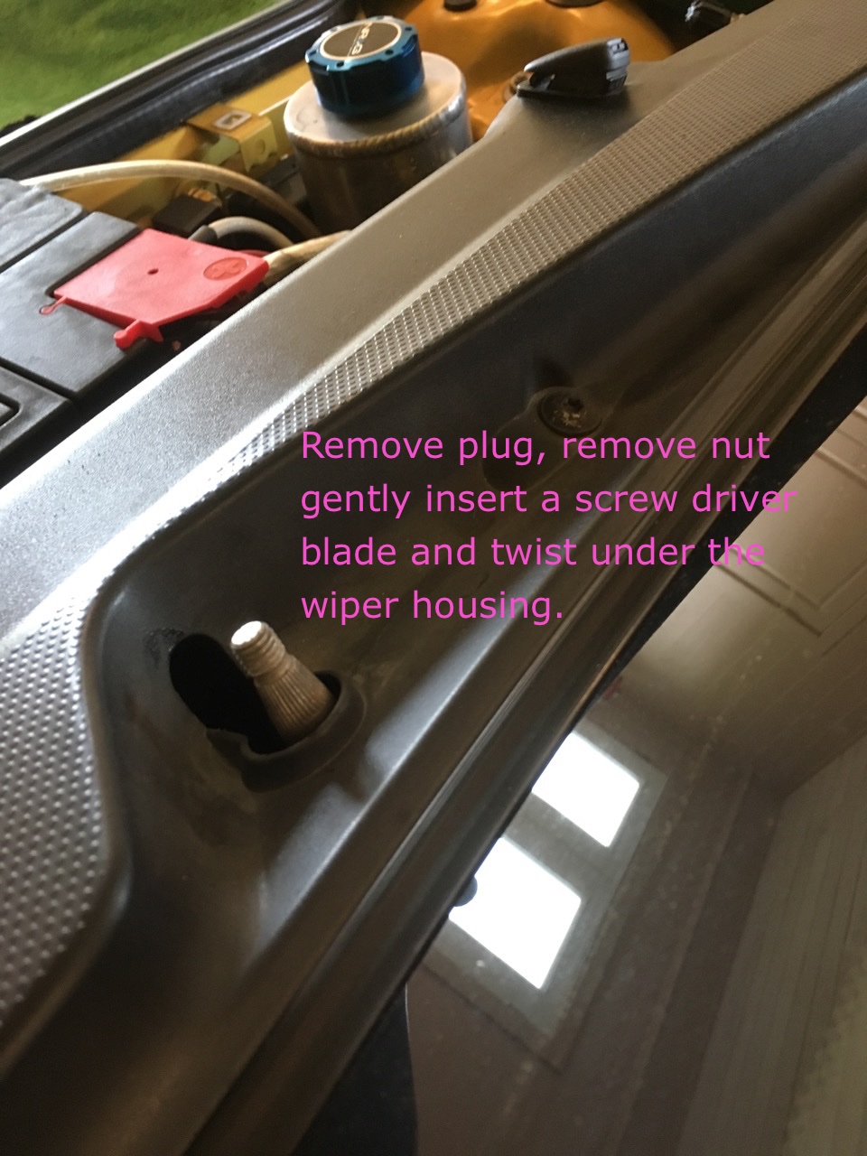

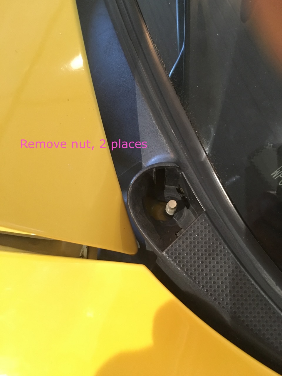

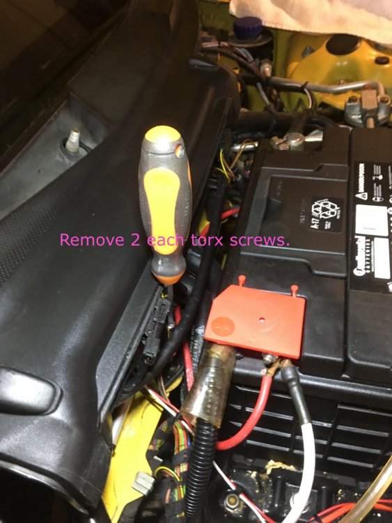

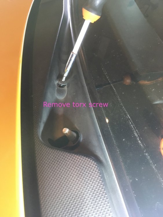

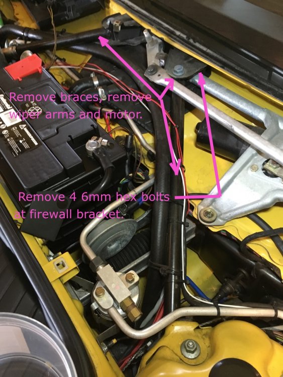

The problem I had was there was no way to remove the door without removing the evaporator housing.  The original tech tip was performed on a Boxster, my 2003 C4S evaporator door would not come out of the lower pivot housing.
I would suggest anyone that wants to try this, first be sure that the bottom pivot will come out, then attack the topside parts for removal.
On my 2002 Targa, I was able to remove my hot/cold blend door through the heater core housing, however there is no way to get at the other door.
