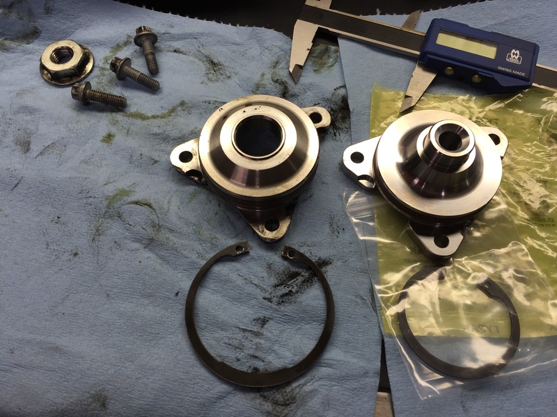

Did that before pulling the tensioners out. I now removed the IMS flange and realized that the old c clip holding the bearing in place is about 15mm wider diameter than the replacement one in the LN kit, and the old bearing itself looks 15mm larger than the new one. Is this just a shell / seal and the actual bearing in a smaller diameter shaft behind it?

You pictures are not showing, try that again with photos of everything you are referring to.
I have to ask a question:  What is the size of the center bolt nut (in MM) that was on the original bearing?  Is it 22 MM?
  On 5/15/2015 at 11:14 PM, Ahsai said:
Yours looks like the M97 larger bearing, which can't be extracted? Was the engine ever replaced?
That is exactly were I was going.  I'd also check the engine number for either "AT" or "X" in the sequence.

Its 22mm. Does this mean I just wasted more than a week+$1500 pulling all this apart and now have to put it back together again with the old part in place?

The only factory IMS bearing that used the 22 MM center bolt was the last design, which unfortunately is the non serviceable unit.  While you have the car apart, it would be advisable to remove the IMS bearing rear seal (using something like a dental pick) so that the oil mist in the engine can lubricate it.  We have several customers running this way without any issues.
A couple of "take a way's" for those reading this thread and thinking about doing an IMS retrofit; first always check the engine number for the presence of either "AT" or "X", which indicates a replacement engine, which could mean a non serviceable IMS bearing.  Second, and this is a big one, unless you know for a fact the engine is pre 2000, or 2002 to 2004 (so you have a reasonable chance of which style bearing is in there), do not buy the IMS bearing before you take the car apart.  Many vendors of the LN kits will not take them back or even exchange them.  While you can always recoup what you spent for the LN tool kit, pre purchasing the IMS bearing can be hazardous to your wallet, as they make very expensive paper weights.

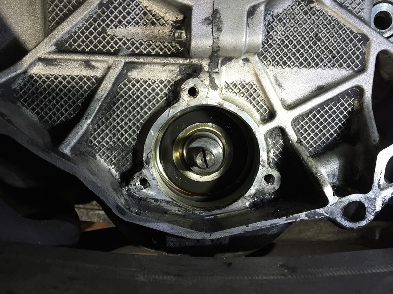

Thanks for the advice. By "removing the IMS bearing rear seal", are you referring to the black seal at the forward end of the IMS that I can see now that the IMS flange is removed, or is there another behind that? Should I apply any grease after removing the seal, or would that just get washed straight into the engine oil?
There was only maybe 1/2 fl oz or 20ml of oil behind the IMS flange when I removed it, as there was nowhere for it to be retained, it all drained out in the slot in the engine case that the c-clip falls into when you remove it from the retaining groove.

Yes, you want to remove the black seal that surrounds the center bolt on the IMS bearing.  In doing so, the oil mist that is circulating in that area will constantly lubricate and cool the bearing.  You do not need to apply anything to the bearing.
