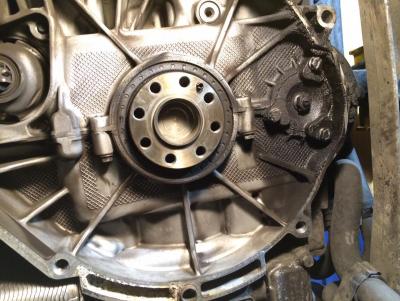

Took 5 min to pull the FW with the gun.  Behind it found a surprise, the oil leak looks to be from the IMS flange, not the RMS.   RMS is old style (it was replaced 2X under warranty).   I had already ordered a new RMS, and have access to the Porsche install tool.
Should I leave well enough alone or replace the RMS?!

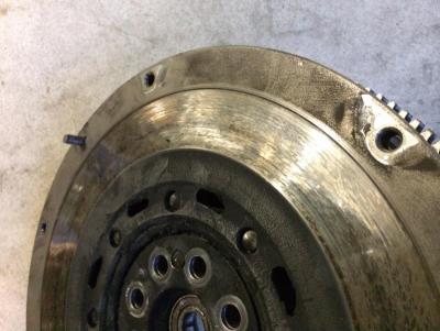

100k mile flywheel passed movement and return-to-center test with flying colors, but there's a lip and the worn face doesn't feel perfectly flat.   Ordered a new one.

We always replace the RMS once you get that far in, the newer PTFE design is much better than the old style seals.  I would also do the AOS.

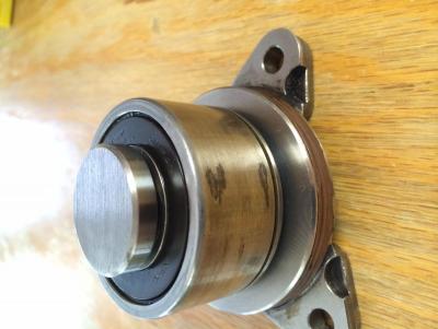

Bearing is out without issue.   I notice a few marks on the outer race (see pics)...   Do I really need any bearing retaining compound for the new one?  Or do they all pretty much look like this?    The old bearing looks and feels like new otherwise.   I want to to finish this up!

Pull the seals off the bearing and see if there is any grease still in it.
You should not need any retaining compounds on the new bearing as it should be an interference fit.  I would however look that the inside of the shaft to see if it has similar marks.
So just skip the bearing compound?  Do you ever use it for the IMS at your shop?
Reading the LN instructions and a post by Raby, they say "consider" using bearing compound if there are signs of movement / ovality in the s_haft.   It likely moved a little up/down as there are a few smaller marks 180 degrees from the ones shown.   But then it's gone 100k miles and doesn't look like it has spun in the sha_ft.  I'd prefer not to use compound as it could make installation and removal more difficult.
The bearing is full of oil, no grease.  The inside of the IMS looks OK, no marks.
