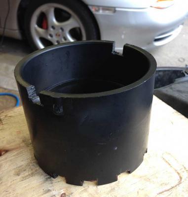

Gas tank. Need to remove that big screw cap. Went to Home Depot and bought a 4" (5" external) ABS fitting which I plan to modify to make the "special tool".

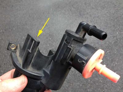

Thanks to Gelbster in the 986 forum for pointing me to this post by Dale_K in the Pelican forum. In fact, it was the magnetic switch which was not inserted into the space provided for it in the valve. It had fallen out when I pulled the old valve but I didn't notice. I did see it but couldn't find any information on it until I saw this post
If this unit isn't working you'll have trouble filling. Also the magnetic switch. A new one comes with a new vent valve.

Machster, this is the switch you need.
  On 9/6/2014 at 7:14 PM, NewArt1 said:
Thanks to Gelbster in the 986 forum for pointing me to this post by Dale_K in the Pelican forum. In fact, it was the magnetic switch which was not inserted into the space provided for it in the valve. It had fallen out when I pulled the old valve but I didn't notice. I [/size]did see it but couldn't find any information on it until I saw this post[/size]
If this unit isn't working you'll have trouble filling. Also the magnetic switch. A new one comes with a new vent valve.[/size]ventunit001.jpg

Bless you for this post!
i had disconnected the filler assembly to replace the a/c return line. Like you, I found the coincidence of failure too unlikely.
the mag switch is poorly documented and probably sells a lot of replacement valves...
regards & thanks!
