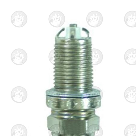

My question now is ..... how do you measure the "gap" with these 4 electrode plugs?  The center electrode stands above the plane of the four ground electrodes.   The spec is 1.6 mm + 0.05 mm.

I've got a tool that looks just like that - made by Blackhawk - made in the USA of all places.  I know how to work it for standard one-ground plugs where there a "gap" between the center electrode and the bent wire ground electrode.
But the Bosch plugs are supposed to be gapped properly when you buy them.  The gap on the new plugs looks to be just every so slightly narrower than on the used plugs.
As per the photo, there's a gap between the grounds and the center insulator, but the center electrode stands high over where the grounds are.....I'm not sure which dimension is the "gap" called out in the spec.
Edited by Dennis Nicholls
Americans seem to be amazed and confused by the notion of spark plugs being correctly gapped out of the box. That is, in fact, standard practice for the combination of German engines and German spark plugs. Since the 1970s when my experience with German vehicles began, and probably longer than that. That gap will be indicated on the box, although not necessarily for multi prong plugs. You won't find a gap spec from the engine builder most times when multi prong plugs are specified. Just install them.
