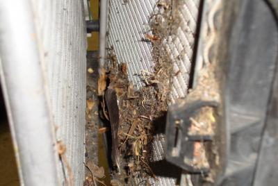

I know the oil is fine, will check coolant when the car cools down around lunch time. There is a tiny bit of debris near one of the radiators, I'll clean it out with my shop vac when I get home tonight. Is this dangerously hot?

I just drove my car again today and activated the OBC readings in the HVAC controls. Temp peaked at 104 for a minute or two but generally stayed around 102. Still not sure how to check for the operation of the fans but definitely want to check that. The water pump was done in the last two years so I'm not worried about that. The temp only spikes when I am in slow traffic and the temperature is in the mid 80s or higher outside. When driving at normal speeds it never goes over 100.
