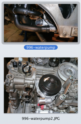

Anyone know if there is a special in getting the water pump back in place on 02' 996. I was able to easily get it out by wiggling it but having major trouble getting it back in due to a metal pipe that is in the way. Thermostat if blocking the pipe from dropping and I don't even want to mess with removing thermostat. I know on gen 1 996 u can drop the metal pipe but I can't see how u can do it with 996.2
The metal pipes under the engine are trivial to set loose, simply take out a few screws under the engine near the oil pan and then separate it from either plastic tube. You should now have a bit more space to work with. You can also drop your engine a bit (less than 2" though!) by loosening engine mounts if you think that helps, but I doubt it. I changed my water pump and thermostat when I had my engine out. Have fun and take your time  :beer:
I assume with the metal pipe, you mean the pipe that is visible right left from the pump on my first image?

Some have dropped it in from the top.  You have to remove an idler pulley to get clearance.
