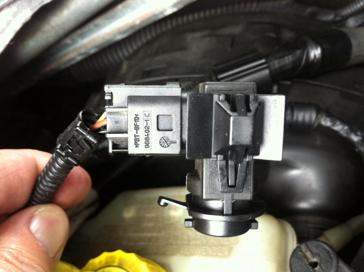

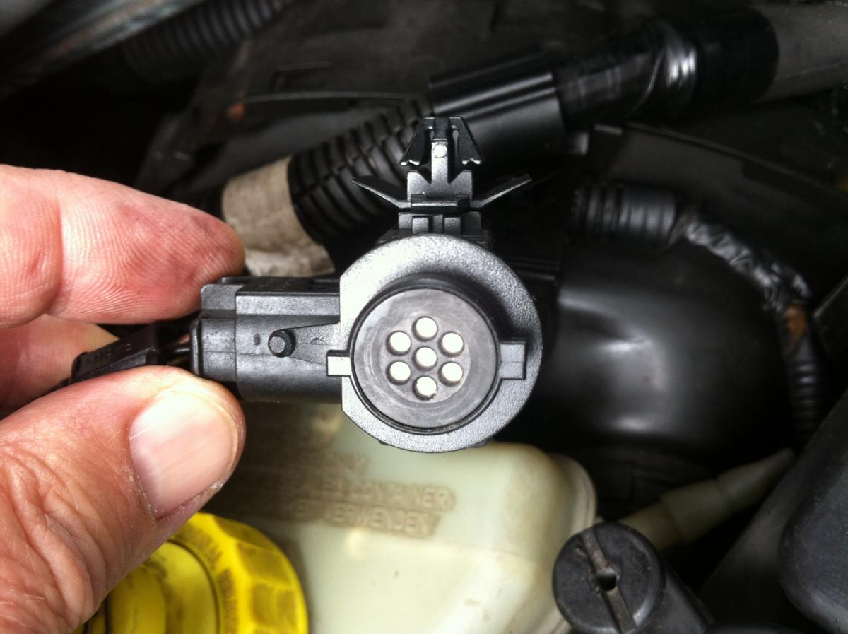

Open the hood and get access to the place where the fuse
Box is in the engine compartment drivers side. Here i found this part
Hanging arround. What is it? Where it has to be installed? Thank you

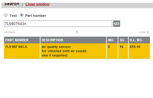

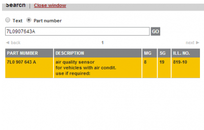

"The air quality sensor monitors ambient air pollution and sends a signal to the Climate Control Unit. The control unit will command the recirculation flap to close if the concen- tration of pollution is excessive.
The air quality sensor reacts to oxides of nitrogen (NOx), Carbon Monoxide (CO) and Sulfur Dioxide (SO2).
The air quality sensor is in the fresh air inlet on the left side. "
