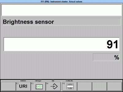

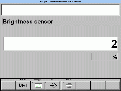

It sounds like your ambient light sensor (for the dash lights) is bad.
If you have Durametric or PST2 or PIWIS access you can test it easily.
It should change based on ambient light.
post-1-0-71606200-1403842986_thumb.gif post-1-0-35865300-1403842990_thumb.gif
