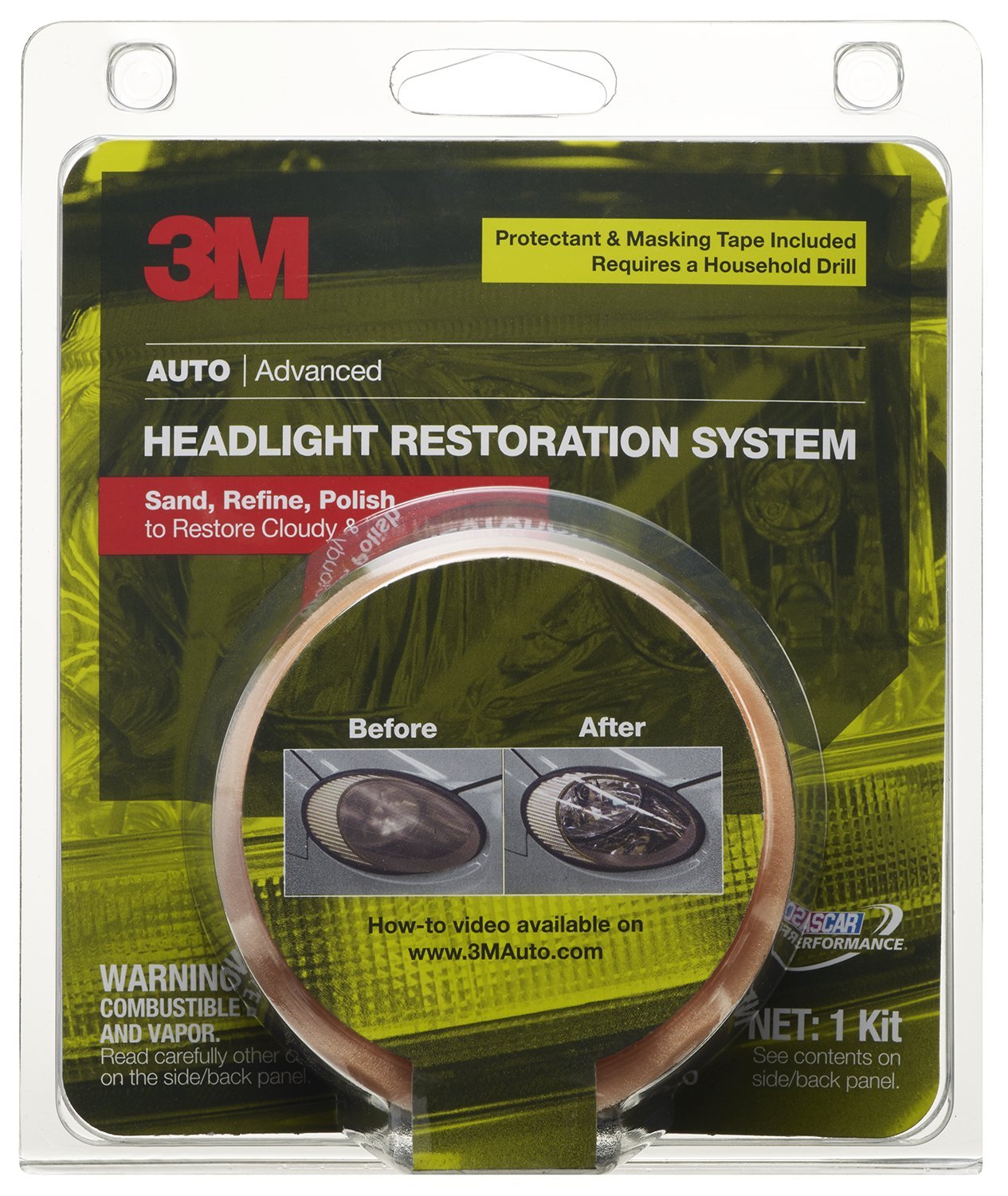

Headlights with crazing, which is what yours sounds like, probably will not benefit from the over the counter cheap kits which are designed to deal with hazed over units.  For major scratches or crazing, you are going to need to go to sanding.  Fortunately, 3M makes a pretty good kit for this that contains several abrasive grit levels to sand out the problems, plus a polish to remove any haze, and protectant to apply when the lights are done.  You can find these at Wal-Mart, Amazon, and many other outlets:
3M kit is really good. I recommend applying a Xpel clear film after. Otherwise the UV will re-damage the lights.
+1 on the 3M kit.  Buy 2.  I went through a whole kit on each lens on my Boxster.
+1 on a good UV protectant too.   1 year after the refurb, my headlights started to yellow.  Quickly got rid of the yellowing with ScratchX, but it would not have been necessary if I had taken the time to put a good UV protectant on them.
