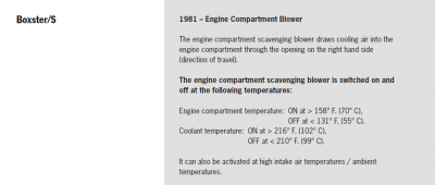

With all due respect particlewave, there must be something wrong with the rotation direction of the fan on your car. There is effectively outside air blown over the engine as indicated by Loren, hold a sheet of paper against the grille when the fan is operating, it remains sticking to it.
particlewave - I am sorry but you are wrong.
Here is the functional description of how it works from the Boxster (986) Service Technik.
(click to enlarge)
And... just to clarify I am a moderator as well I am the site founder and owner.
and RFM is volunteer moderator and former Porsche factory employee.

It is not a cooling fan it is a purge fan and only comes on when certain criteria are met.
See the image below (click on it to enlarge it) for the details of how it is triggered.
