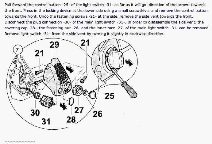

Can anyone tell me where I can find detailed instructions for removal of the front center console that surrounds the nag, etc on my 996TT. Just do not want to break the plastic. Want to have it painted body color. Also the vent surrounds etc. if there is a source.

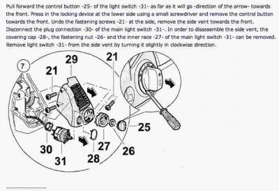

MY? You mean the horseshoe that surrounds the NAV unit? It just pries off. The vent....here:
post-4605-0-61399600-1400022324_thumb.jp
