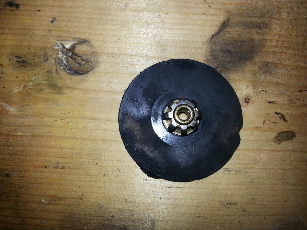

Are these shims re-usable? Had to use a blade to get them off the brake pad, had some sort of glue in the back. Would that be the anti squeal paste?
post-15979-0-19223400-1399226473_thumb.j
Yes they are if they look undamaged. You can use anti squeal paste as you suggest or just put them back in as is which is what I did and have not noticed any squealing.
