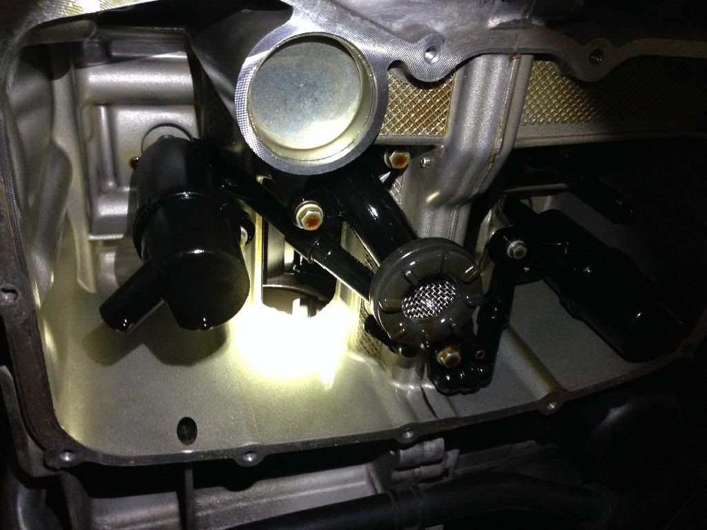

Yes both times I purchased new aos. I'll take the sump off today. Is there anything in specific I should be looking for? Also is it possible to remove the oil pickup tube to clean the filter screen better?

After oil draining, there should only be some residual oil. Look for anything other than oil like metal, plastic, RTV, silicone bits. Once you have that off, it is easy to inspect the oil pickup without removing it. You will also see two internal AOS units inside which behave as oil de-foamers. Might be worth a shot to remove and check that those do not have obstructions (about $35 each to replace). Here is what you will see:

Thank you for the pictures, I'll let you know once I have it all removed.
