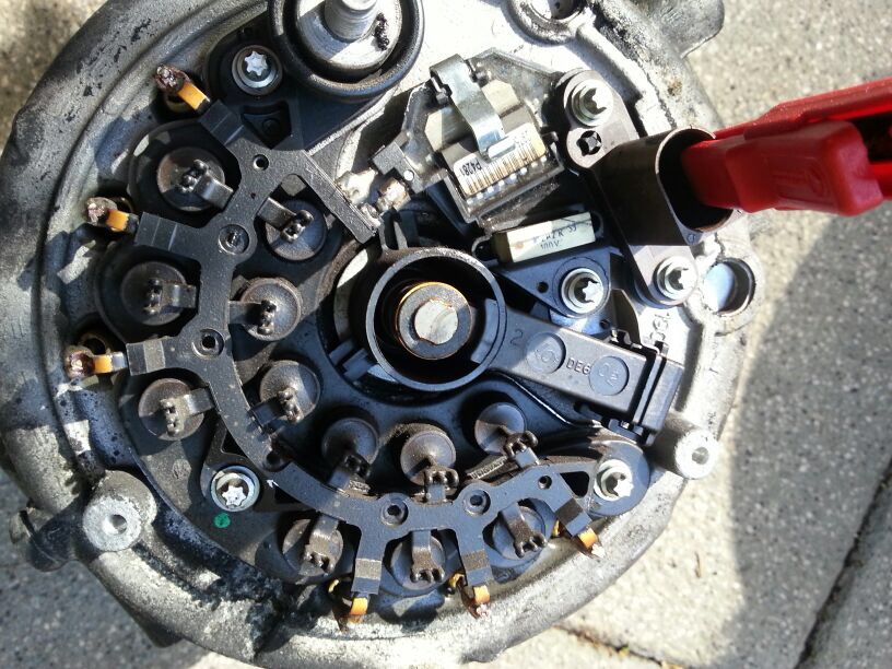

Mmmmmmm. The old alternator i have here. Is the regulator a external part or is it inside the alternator?
  On 5/18/2014 at 1:27 PM, ekstroemtj said:
I found a diagram. Can somebody please point
Me to the regulator.
The regulator is internal to the alternator, you have to open it up to even see it:
Best bet is to get another alternator (new or reman) and have it load tested BEFORE putting it on the car because there are other electronics that can also go wrong inside the alternator (e.g., power diodes).
Anyways, it's Porsche center's problem now under warranty work :)
I wanted to have a look inside to the old one but i dont
The right tools to open the black cover.
Ahsai you are right, it should be their problem. What i see now its a fight
Between the porsche shop and the manufacturer of the alternator
About the labor for changing this part a second time.

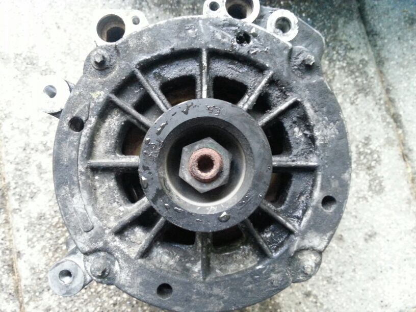

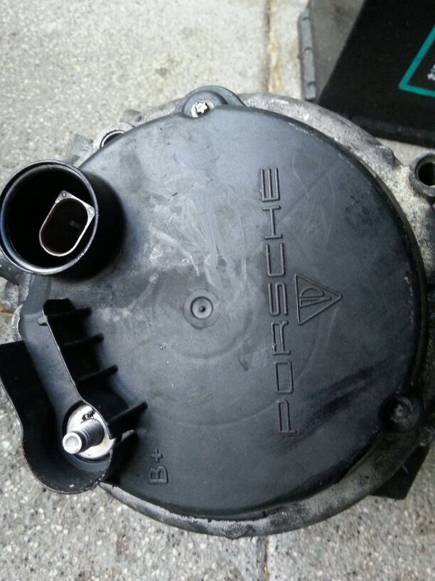

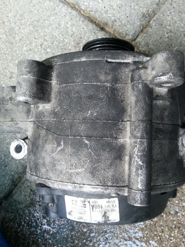

post-77547-0-61904600-1400438000_thumb.j
post-77547-0-75293300-1400438013_thumb.j
post-77547-0-14182800-1400438033_thumb.j
post-77547-0-49815800-1400438084_thumb.j

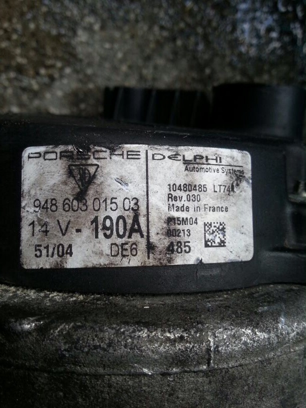

  On 5/9/2014 at 9:55 PM, ekstroemtj said:
Its a remanufactured from Bosch. Before i took it they run a test. Output was between 13.70 and 14.5
Ok, looks like your alternator is manufactured by Delphi. I have searched and couldn't find any Bosch equivalent unit. If it's a reman, you would think it's from Delphi and not Bosch. Does the Bosch center recognize the alternator as a Bosch reman unit?
Btw, seems no parts are available for rebuild according to this thread, not even the regulator.
http://forums.rennlist.com/rennforums/porsche-cayenne-forum/774694-2004-ctt-water-cooled-alternator-r-and-r-oh-joy.html
Ahsai.
The pictures are showing the original alternator which they took out 2 weeks ago. Its the OEM part from the car which was running there for the last years.
Now i have a remodeld inside which is not working proper too as i described. It was reman by BOSCH according my information. If you look for a alternator for a Cayenne here in Germany, you can find Delphi, Hitachi and Bosch.

Most of them are but this design is different. Looks like you're right that the pins need to be desoldered in order to remove the regulator.I found the regulator for Delphi alternators 10480403 and 10480407 so not exactly your model but looks similarly designed http://www.ebay.co.uk/itm/VERG1155-12-VOLT-ALTERNATOR-REGULATOR-MERCEDES-DELPHI-DELCO-REMY-235542-/300857909741?pt=UK_CarsParts_Vehicles_CarParts_SM&hash=item460c8761ed
Looks like Mercedes and VW also use these water cooled alternators. Maybe a correct replacement regulator for yours IS available out there somewhere.

Here you can see the diode pack side of the two pins. Seems the pins just plug into each other but it's hard to tell whether any crimping or soldering is needed by design. I wonder if someone has been inside your alternator before and soldered those pins... Photo taken from here.
post-5282-0-80827900-1400519365_thumb.jp
